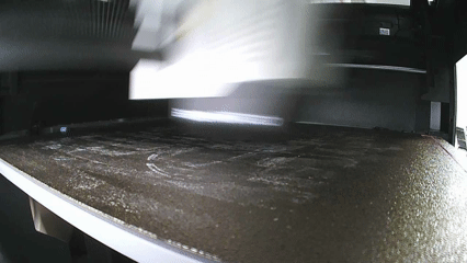

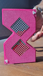

The design is half the project! We need an enclosure that not only looks sleek but also securely houses all the components. I modeled a smooth, tapered case in Autodesk Fusion 360 that mimics the iconic hourglass shape with a twisted figure.
I printed the enclosure using a Bambu Lab P1S 3D printer. You may notice in the video that the top plate “disappears”—that’s because I removed it after the print was completed.
To make things easier for you, here are the STL files for the entire case.

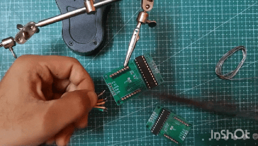

Start by tinning all your wires for cleaner and stronger solder joints. Use solder flux properly while tinning—it makes a huge difference in connection quality.
When cutting wires, measure their length precisely according to where each component will sit inside the 3D-printed case. Neat wire management makes the entire build look more professional.
Now, follow the circuit diagram and solder the components together:
Wiring the First MAX7219 (LED Matrix 1)
MAX7219 -> Arduino Nano
  1. VCC -> 5V
  2. GND -> GND
  3. DIN -> D5
  4. CS -> D6
  5. CLK -> D4
Wiring the Second MAX7219 (LED Matrix 2)
Connect the OUT pins of the first matrix to the second matrix:
OUT (Matrix 1) -> IN (Matrix 2)
  1. VCC -> VCC
  2. GND -> GND
  3. DOUT -> DIN
  4. CS -> CS
  5. CLK -> CLK
This way, both matrices form a daisy-chain and respond to the Arduino as a single extended display.

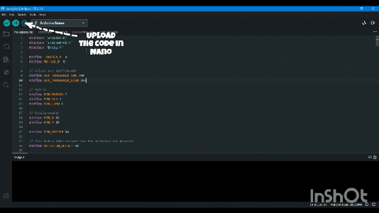

I’ve uploaded the full source code for Twixie on my GitHub. You can download it directly from here.
Once downloaded, save the files inside a folder named hourglass.
Open the hourglass.ino file—this is the main program. The remaining files are supporting modules used by the code. I avoided using certain pre-made libraries because they often create upload issues on the Arduino Nano, so everything here is clean and ready to compile.
To upload the code:
  1. Open hourglass.ino in the Arduino IDE.
  2. Connect your Arduino Nano to your computer using the USB cable.
  3. In the IDE, select the correct board:
  4. Tools → Board → Arduino Nano
  5. Choose the appropriate COM port (as shown in the image).
  6. Click Upload.
After the upload completes, your code is ready—and so is the digital sand simulation at the heart of Twixie.

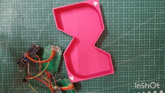

Now it’s time to assemble everything and bring Twixie to life!
Begin by placing all the soldered components onto the base plate of the 3D-printed model. Use a hot glue gun to secure each part firmly in place. Make sure the charging module and push button are aligned correctly with their designated slots in the case.
NOTE : Mount the accelerometer in the same orientation shown in the video. If its direction is changed, the LED “sand” will not flow correctly.
Attach all components to the base—except the LED matrices. These will be mounted on the top plate of the enclosure.
Once everything is positioned properly, close the hourglass by placing the top plate on the model and sealing it using super glue.

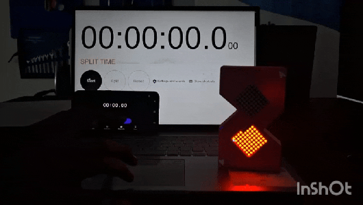

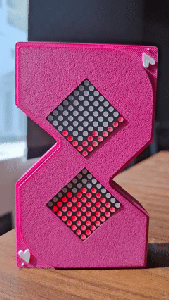

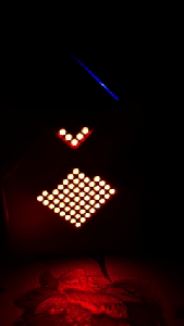

Twixie uses 60 glowing LEDs, with each falling LED representing 1 second. As a result, a full cycle of the LED drop marks almost 1 minute — taking about 1 minute and 2 seconds to complete👉🏻👈🏻.
