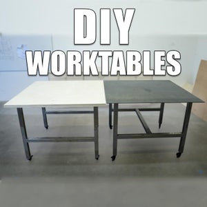

Step 1: Metal Top
For the welding table, we started with a 4ft square sheet of ¼” thick steel and removed the surface rust using a wire wheel on our angle grinder. We’re going to build this table upside down for a couple of reasons:
1) because our floors are far from level and
2) this way, we can make sure the legs are aligned relative to the steel top.
Step 2: Dry Fit Legs and Stretchers
Once we cleaned off all the surface rust, we placed the semi exact legs on top and placed pre-cut 2x2 square tubes in between to tie the two legs together. These stretchers aren’t necessary, but we wanted to make sure this table is able to handle a decent amount of weight and use, so we took the extra step. The top stretchers interfered with the welds on the legs, so we cut out a small bevel to clear the beads on each side
Step 3: Welding
We marked the position for the bottom stretcher and clamped it in place. Then we welded everything together, making sure to switch our welding position from one side to the other to minimize any distortion from the heat.
Step 4: Cleaning Up the Welds
We flipped the frame over to clean up the spatter and dressed up the weld beads, because to be honest our welding skills aren't of presentable quality and we wanted to make it look relatively pretty.
Step 5: Welding on the Top
Then we flipped the frame back upside down and positioned it on the center of the tabletop by measuring around all the sides evenly. We stitch welded it into place similarly moving from one side to another to reduce warping.
Step 6: Add Casters and Flip Over
The legs have threaded inserts on the bottoms, so all we had to do was screw on these locking casters and we can fine tune the height if we need to.
Then we carefully flipped it over - We estimated the table weighs about 180lbs, so having two people is definitely important.
Since we used raw steel for the table, we sanded everything down and rubbed a thin coat of WD-40 to prevent any rust from forming.
Step 7: Cut Plywood
With the welding table complete, we moved onto our assembly table. This one is going to have a simple plywood top. We used our Kreg Accu-cut attachment to cut down a sheet of ¾” plywood in half, so we can fold it over hamburger style.
Step 8: Spread Glue
We made sure to spread a generous amount of glue on both halves. We tried using a paint roller to spread out the glue, but it soaked up so much that we felt that a plastic spreader performs infinitely better at this job.
Step 9: Clamp Top
Once the glue was evenly spread, we sandwiched the halves together, clamped it all around and let it cure overnight.
Step 10: Cut to Size
Once the glue was cured, we cut a thin sliver around the perimeter to make sure we have crisp, even edges all around then sanded the edges with 120grit sandpaper.
Step 11: Screw on Legs
Then we lifted the legs on to the top and screwed them in using 1- ¼” screws with a small washer to make sure they’re captive on the slots.
Step 12: Add Casters
We used shorter casters on this table to accommodate for the extra thick tabletop because we forgot to account for the height difference when ordering the legs.
Then we brought the table upright onto the floor and that's it!
Since we got the prefabricated legs, it made both of these projects so simple.
