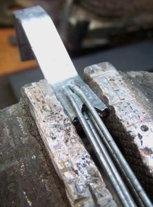

A friend gave me an old hard drive magnet split in two pieces. These were not fastened on their mount and were easy to remove. I want a magnetic grabber with more strength than one magnet provides. Also shown is a piece of steel about 3/32 inch thick and 1/2 inch wide.
Step 9: Bend the Steel
With a vise and a hammer I bent the steel into the pattern you see. See the text box for where the magnets will be placed.
Step 10: Prepare to Wind the Wire Handle
I chose to wind three strands of wire together to make the handle. Three twisted strands of #13 steel wire will provide enough strength for what is necessary, but can be bent whenever the head of the grabber needs to reach around a corner. Later it can be straightened again. This will be a simple plan for construction of the handle, but the handle will provide plenty of versatility. See the text boxes for information about the hole and the "V" notch I made in the piece of steel for the head.
Cut one piece of wire 36 inches long and bend it over at 18 inches. Stick one end into the drilled hole. Cut another piece about 22 inches long. Bend it over at about 18 inches. Stick it into the drilled hole.
Step 11: Twist the Wires
With the steel head in a vise as in the previous step, insert the ends of wires into a drill chuck. Use the drill to twist the wires. Do not twist too tightly.
Step 12: Finish Off the Twisting and Add the Magnets
I had to use a pair of pliers by hand to get the twist tight enough near the "V" cut so the twist went into the "V" and made the head solid on the wire handle. You can see the magnets in place in the upper right portion of the photo.
I used a grinder to smooth sharp corners, and I covered the magnets and the ends of the wires with some electrical tape for a tool that looks more finished and has fewer rough edges.
