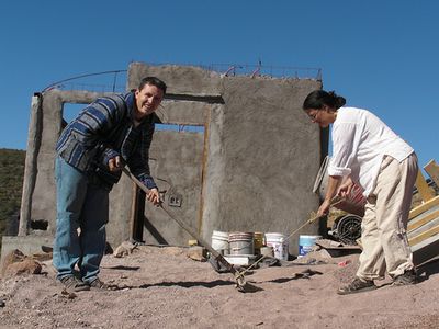

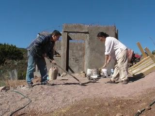

As for the application, that's a little more complicated, simply because you expect it to be harder than it is. When we first used this shovel, we were each riddled with guilt that the other person must be doing all the work. It seemed too effortless. Only when we switched positions did we believe that neither person was really exerting themselves. It is great!
One person, “A”, holds the shovel. The other person, “B”, holds the rope handle. “A” places the shovel head on the ground against whatever it is that has to be shoveled. “A” does NOT push, he simply guides the tool. “B” pulls the handle (and thus shovel head) towards her, scooping up the material (sand, dirt, whatever) to be removed. “B” then lifts the handle upwards and “A” guides the shovel, using the shaft as a lever, to where you need to dump the material. Rhythm is the key, and after a few tries, the team can move a lot of material without straining.
