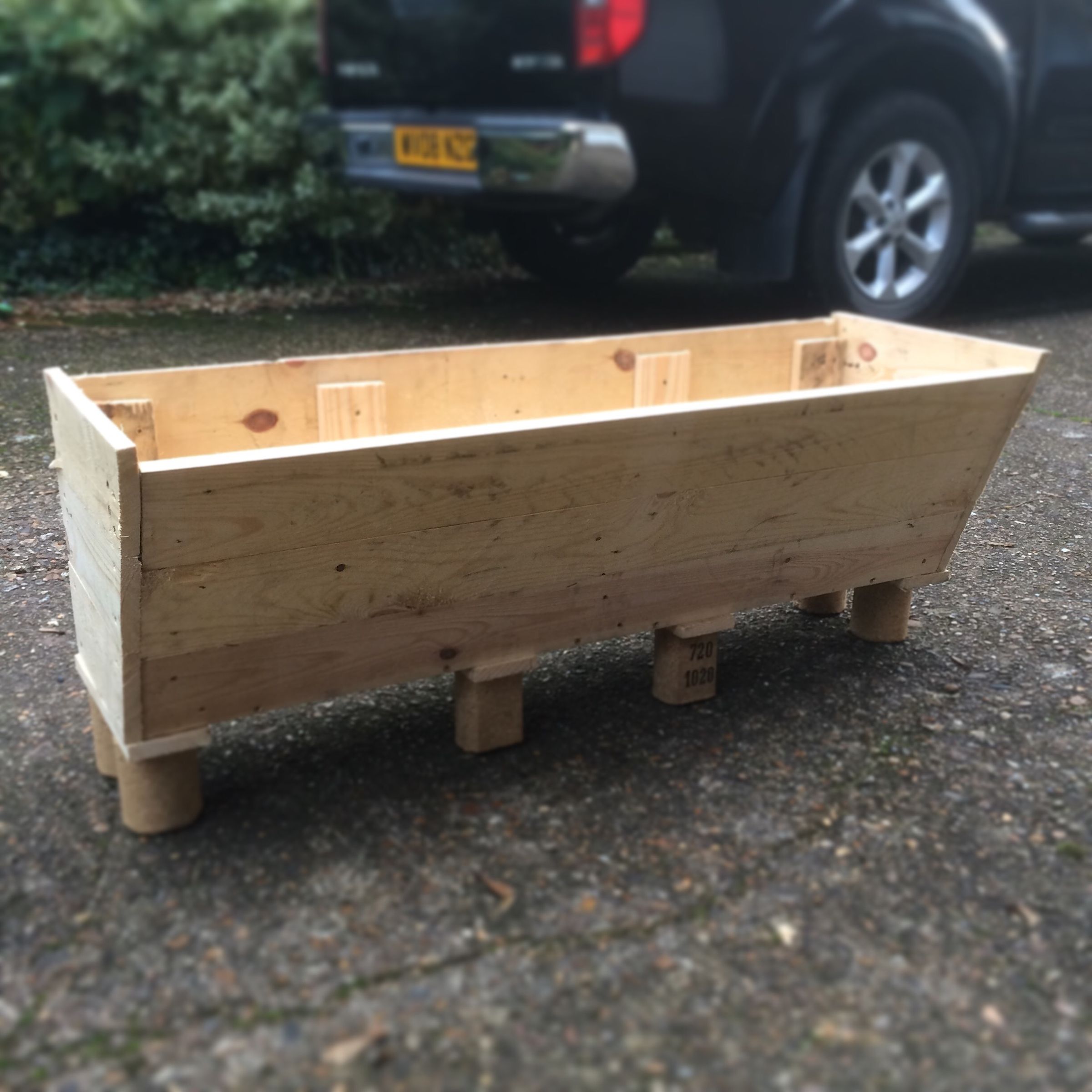

We set out the floor pieces and measured two end pieces and a middle pieces that over hung slightly to allow for the sides and wall to rest on and picked the feet we wanted to use
Step 3: Step 3
This time once we had made the base we picked out a piece of wood that had curved ends and decided to use it on the top piece for decoration at the back. So that it didn't look odd we offered up the side walls and aligned them with were the start of the curve is and cut them to be central.
The side walls this time we cut with the angle we wanted and fitted them to the back and then city and fitted front to it and drilled them in. This way is much easier and means less joining pieces.
Step 4: Step 4
Drill the sides to the front and add any supports needed. We used 4 just to make it a bit more ridged.
