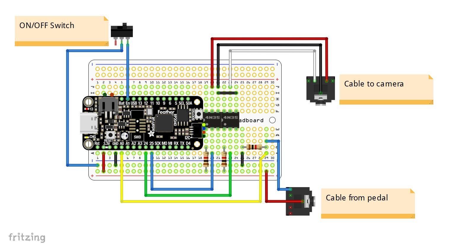

Step 2: Circuit Diagram
I used Fritzing to create the wiring. I have found it helps me document the circuit before moving from breadboard to permanent solution.

For this project I used the Adafruit Feather RP2040 because it has built in lipo battery charger and connector. This allows me to easily use on battery power and have one less cable in my way. Also by wiring a toggle switch from enable to ground you can have an easy on off switch.
I also used 4N35 optocouplers to prevent damage to my camera. Optocouplers prevent voltage from circuit going to the camera. For the shutter to work I just need to ground the tip connector to sleeve. For focus it needs ring grounded to tip.
