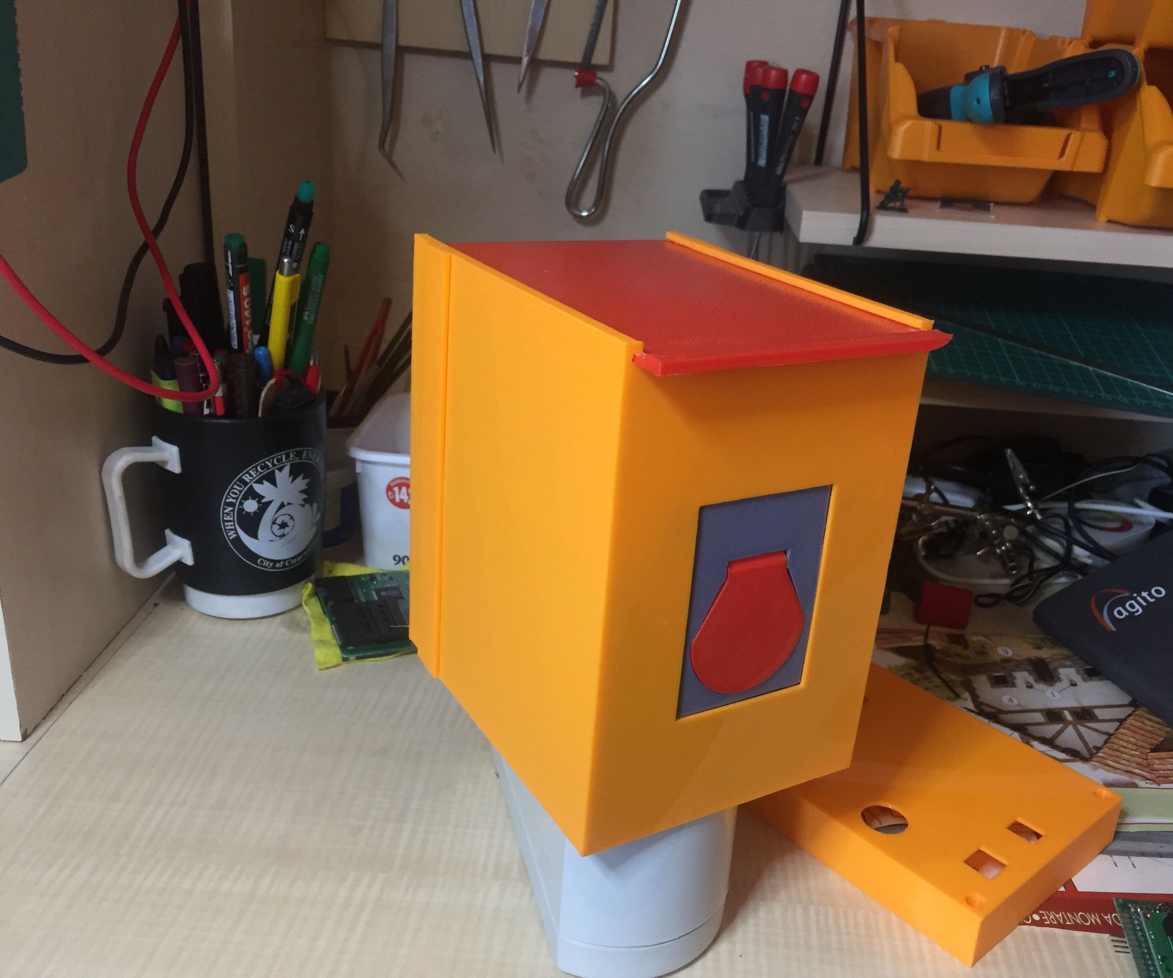

I used this method to make pcb of Automatic Cat Feed Dispenser instructable.
