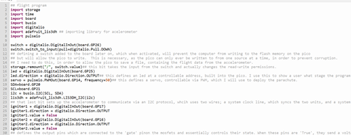

This was written in circuit python, as all Adafruit libraries, including the one for my accelerometer, only work in circuit python.
Since formatting errors occur if I copy and paste this code, I have linked it here;
https://github.com/Toms-Project/Two-stage-electron...
For those who are uninterested, the Code essentially turns on the rocket's led and begins flashing it, to let the user know the rocket is 'armed'
It then senses for a completed circuit over a pin, which is connected to a 3.3v load once the launch switch is flipped
Once it is flipped, it fires the first stage motor, and begins logging acceleration data from the accelerometer.
After 4.5 seconds; the amount of time for the first stage motor to burn out; the second stage motor is ignited.
If an acceleration input if measured to be 0 (the rocket is no longer accelerating), then the servo motor will be rotated, freeing the parachute.
However, after 8 seconds, a redundancy will kick in, firing the servo anyway, since the rocket should have reached apogee (top of flight) at this point anyway!

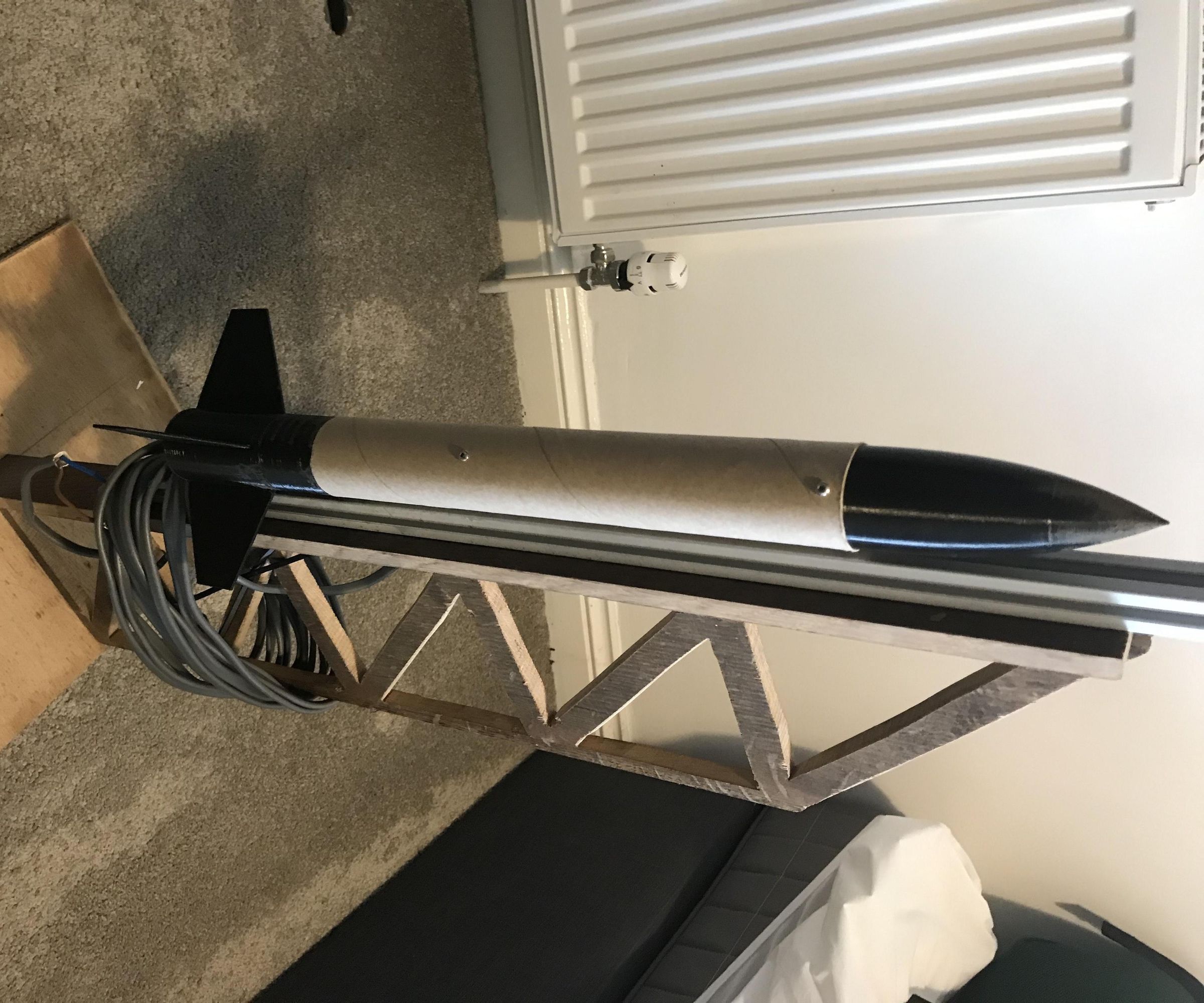

Finally, I put all of the pieces together, and saw what the finished rocket looked like for the first time! I then weighed my rocket for the first time, and found it was 330 grams fully laden - 85 of that was the motors! While the recommended max lift-off weight was 396 grams, I still felt this was a tad overweight, so I re-designed a few components. I re-designed the battery holder- now the 9v battery was inside the nosecone, rather than having it's own holder. The avionics bay was shortened, alongside the lower stage connector, and lower stage airframe. This lost 25g, and I felt more confident about the rocket's take-off weight.

Step 16: The Launch - and a Few *little* Niggles
I waited for a dry, clear day, and took my rocket to a nearby large field. In the above video you can essentially see what occurred, but I will break it down here too.
The first stage did nothing. After inspection, I found that this was due to a wiring error. No current got to the igniter, and therefore the first stage did not fire.
The second stage ignited on time - 4.5 seconds after the launch switch was pressed, despite having not left the pad. Because of my updated launch lug design, this stage could take off on it's own, despite only having one lug. It separated perfectly from the lower stage, showing that my separator had the right dimensions and tightness.
Annoyingly however, there was a manufacturing error with my motor; the ejection charge simply didn't fire! I examined the upper stage motor after the flight, and found that the clay plug was still in the motor - this should have been forced out by the ejection charge firing.
Because the parachute was therefore not ejected, the free-flying upper stage, started free-falling, and hit the ground with such intensity that the carboard body tube disintegrated, and the nose cone was a full 5 centimetres underground!
Luckily, despite all of the other electronics on my flight computer breaking, The microcontroller itself survived meaning I could see the flight-data! Unfortunately, this was not my lucky day, and the data only ran to 4.4 seconds - 0.1 seconds before It was due to ignite the second stage. My only theory is that the ignition of the second stage must have somehow broken the accelerometer, causing no-more data to be recorded. I also couldn't make the accelerometer work even after recovering it, but this is hardly surprising, given that it did pile into the ground.
Since the first stage did not fire, and is still essentially functional, I will probably make another, smaller rocket, using this first stage. I will post the video of this smaller rocket launching.
