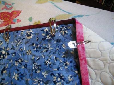

Step 4: Make the Binding
With wrong sides together make your binding by pressing the strip matching raw edges.
Step 5: Sewing the Binding On
Sew the pressed binding to your quilt top using 1/4" seam allowance and placing the narrow strip against the quilt top. Miter the corners as you would normally do.
Step 6: Finish It Up
Bring the binding around to the back and hand sew down. The seam of the binding should lay right on the edge of the binding. I sometimes press the binding to get a crisp edge before sewing.
Step 7: The Final
I like to use binding clips to help the fabric "remember" the fold.

    So I am a little dense and didn't understand this at all. Does the extra fabric on the second side get folded under the other way so that it actually gives a double thickness binding? Or do you end up with a much thicker binding on the underside? From the pictures it is the same on both sides.
