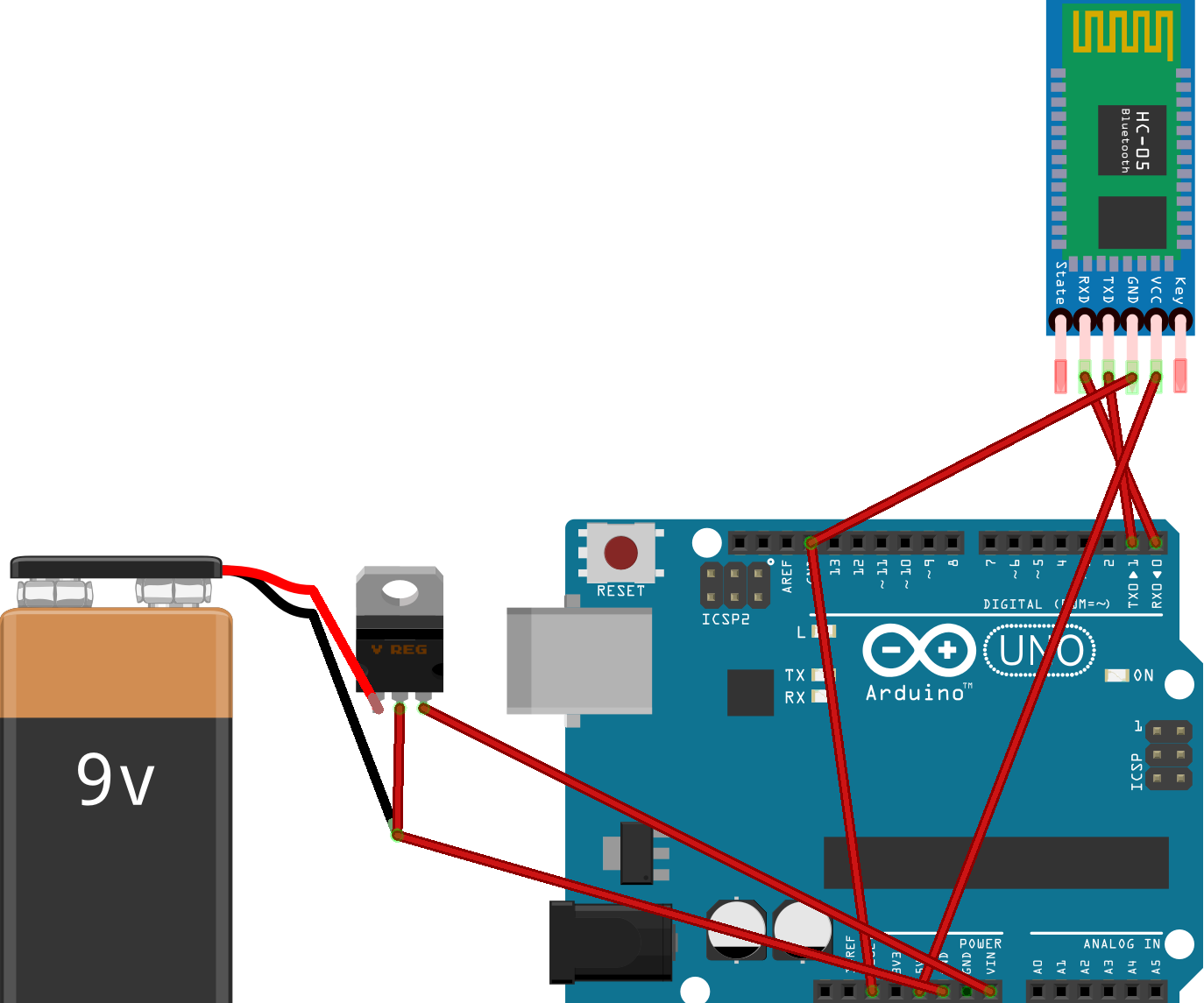

For circuit Motor Shield pins would go as
INT1 = D6
INT2 = D7
INT3 = D3
INT4 = D4
SCL = A5
SDA = A4
For a person like me who hates batteries I shorted 12V with 5v terminals on motor shield and powered them with charger 5V/1.55 A output. You may follow your own power method.
