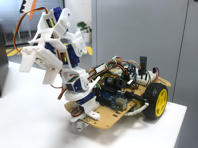

This is a great beginner project for anyone to make! It is a robotic arm mounted on a Two Wheeled Drive vehicle designed to perform various manipulation tasks in dynamic environments. The base consists of a small robot car, often with rugged wheels for diverse terrain. The two main wheels are motorized for movement and steering. The arm, centrally mounted on the car’s upper structure for balance, features multiple motorized joints for movements such as rotation, bending, and extension, all controlled by servos.

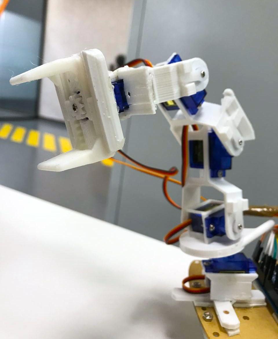

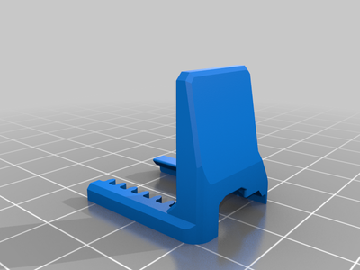

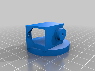

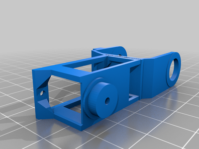

Step 2: Designing the Robot Arm Parts for 3D Printing
There is the design of each part of the robotic arm that will be 3D printed. Using CAD software, each component will be modeled to fit the desired dimensions and functionality. The arm consists of several joints, allowing for movement such as rotation, bending, and extension.
The STL files provided below are ready for download :

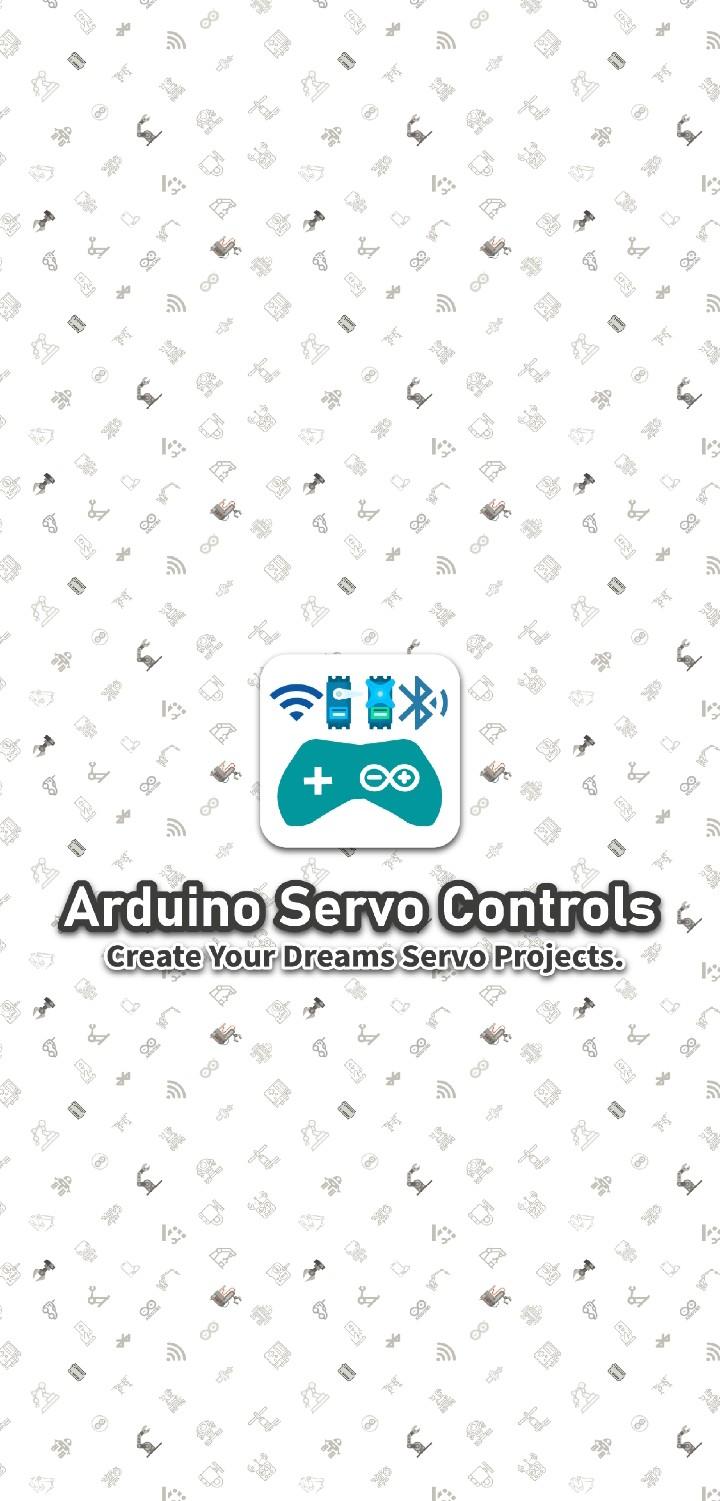

Action 2: Connecting via the Arduino Servo Control App
  1. Download and Install the Arduino Servo Control app on your Android device.

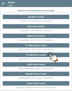

  1. Launch the App: (Follow the steps showing in the pictures above)
  2. Open the app and click on the Pro Mini Servo Control wich is the type of servos whe are using.
  3. The app is showing 6 servos slider form 0° to 180° wich is the angle control of the servo motor.

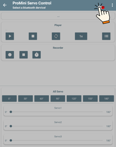

  6. Connecting arduino with the app for Real-Time Control:
  7. Click on the top tree point icon then select devices to search for nearby devices.
  8. Select your HC-05/HC-06 module from the list.
  9. moving the sliders in the app will adjust the angles of the servo motors in real-time.
  10. Test the servos by adjusting the angles to ensure they are moving correctly.

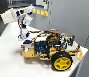

Step 6: Assembling and Testing the Robot
In this step, we will assemble all the components of the robot, including the two-wheeled chassis, robotic arm, servos, and electronics. The two-wheeled chassis is also controlled via Bluetooth using the same app, specifically with slider 6 (labeled as Servo6). The original values (905–1085) are mapped to a range of 0–180, and each movement is assigned a specific range:
  1. Forward: 0 to 45 (original value 905 to 950)
  2. Backward: 46 to 90 (original value 951 to 995)
  3. Right: 91 to 135 (original value 996 to 1040)
  4. Left: 136 to 179 (original value 1041 to 1084)
  5. Stop: 180 (original value 1085)
The corresponding code is provided below :
