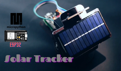

Our goal is to create, design and realize a simple, low-cost, dual-axis intelligent solar tracking system using a photoresistors (L.D.R.),a solar panel and an electronic circuit allow the system to rotate both vertically and horizontally, based on a tracking technique to actively follow the solar radiation and adjust the panel accordingly to maximize energy production and provide better performance.
Who can benefit from this prototype?
The simple design of our system allows it to be used in a science project or as a classroom demonstration, it is dedicated also for students and hobbyists.
To make it simple, we divided this project into several steps to make it easy to be understood and built.
How Does a Dual Axis Solar Tracker Work?
Let's start by Functional principle of the dual axis solar tracker:
Solar trackers are used to continuously direct the solar panel towards the sun's rays, thus maximizing the expectations from this system.
This system effectively tracks the position of the sun and generates more electricity than its counterparts due to the increased direct exposure to sunlight.
This design consists of a model that focuses on the use of a solar panel that would follow the movement of the sun, i.e. azimuthal altitude, automatically adjusting itself each time without human intervention.
To do this, we use photoresistors (L.D.Rs) which will follow the sunlight at each moment and give a signal to the main circuit for the movement of the panel. The movement of the panel will be done by means of two direct current servo motors. All electrical components will be controlled by developed electronic circuitry. The two-axis tracking ensures that the panel is always in the most accurate position for best performance.
In a dual-axis tracker, the panel consists of four LDRs which are used to track the exact position of the sun along the tilt axis and the azimuth axis.
These LDRs are divided into: Top, Bottom, Right and Left, the program works by comparing the resistance of the four LDRs two by two this information is sent to the comparison unit, which is the main control unit for the entire system and determines the direction of movement of the motors in the horizontal and vertical axes.
