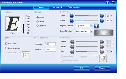

For the laser settings, this is what worked for me to get the two-tone effect to come out.
DPS = 300
Raster Only
Speed = 60 (remember, don't go faster than this unless your piece is really tall - to avoid blowing out the motors!)
Power = 40
Floyd Steinburg dithering (probably not that important for this job...)
Don't forget to make sure your piece size matches your artwork!
To get the settings right, for the first pass I would suggest to set the power really low (like 10%), and print only the "shadows" layer (by hiding the other layers). Then, send the job to the laser and adjust the power on the fly until you get the outcome you want. The idea is to laser through some of the paint, but not all the way through to the metal (your other layers will go all the way through to the metal, and that's how you will achieve the two-tone effect).
