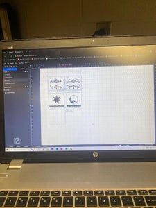

Step 2: Retina Engrave
1. Open Retina Engrave.
2. Click "software," then "Try now."
3. Check the top left; if it says "muse-core," change it to "muse-titan."
4. Click the image icon in the top left and upload your file from festi.boxes.py.
5. Select everything that appears and click the "ungroup" icon (two squares)
near the top right.

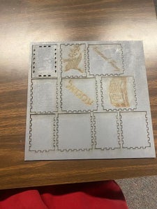

6. Move each piece. Copy and paste pieces to fill as many as possible on an
11.8x11.8 inch wood board.
7. To check if it fits, draw a square, set x and y to 11.8, and see if it fits. Delete
the circle when done.

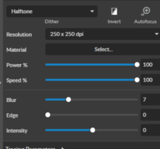

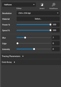

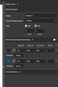

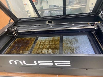

Step 3: Laser Cutting
Set up your laser cutter by adjusting the speed and power. Power is how strong the laser is (keep it at 100). Speed affects how deep the cut is; slower means deeper and faster means shallower. If your box has designs, create a separate setting for them. Use a USB to transfer the file to the machine, adjust settings if needed, let the machine scan the board, and start cutting.

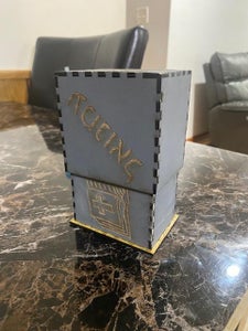

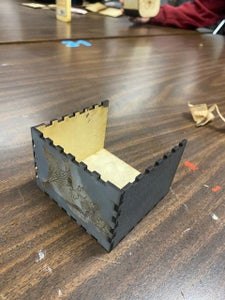

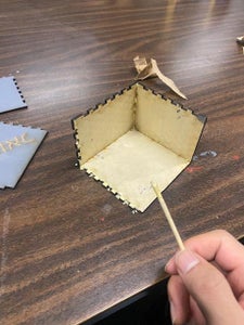

Step 4: Assembling and Sanding
To make the bottom half:
  1. Find the pieces of the bottom half
  2. Put glue onto the sides of the pieces
  3. Connect them all together
  4. Allow the box to dry for at least 24 hours

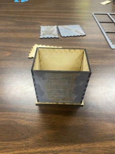

To make the other half
  1. Get the remaining pieces of the other half
  3. Connect them one by one
  4. Allow the box to dry for at least 24 hours before using it.

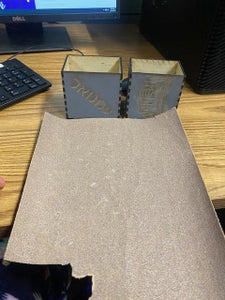

Finally, I had to smooth out the corners by rubbing them with something rough, like sandpaper, to make it easier to put them together and take them back out.
