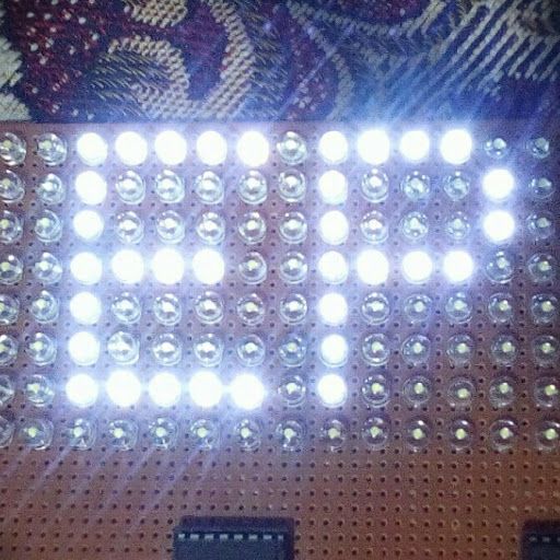

Step 3: Building LED Matrix
For this clock I designed 8x40 Led Matrix. This matrix consists of 5 8x8 matrices that uses 74hc595 8-bit shift registers to control the LEDs. You can build your own LED matrix on a circuit board.
Or you can buy 5pcs of PCB prototypes for only $2 (any color) from JLCPCB to make your project look more professional. If you order now using above link you will get special offer 1-4 layer PCBs with Free PCB Assembly. So, download the Gerber files and click on the link to order now!
Assemble the PCBs:
When all the components are arrived its time to assemble the PCBs. First solder the resistors and then shift registers. You should be careful while soldering the shift registers. Correctly place them on the PCB and make sure that dot on the PCB and on the shift register is on the same side. Then solder the LEDs and Headers on the PCB.
Note: On the first PCB I soldered two shift registers and on rest of them I soldered only on the right side. Because right shift register controls the columns and the left shift register controls the rows. All the rows of matrices are connected to each other using the headers. So, we don't need to add left shift register the rest of the PCBs.
When all the PCBs are assembled connect them together. And our 8x40 LED Matrix is complete.
