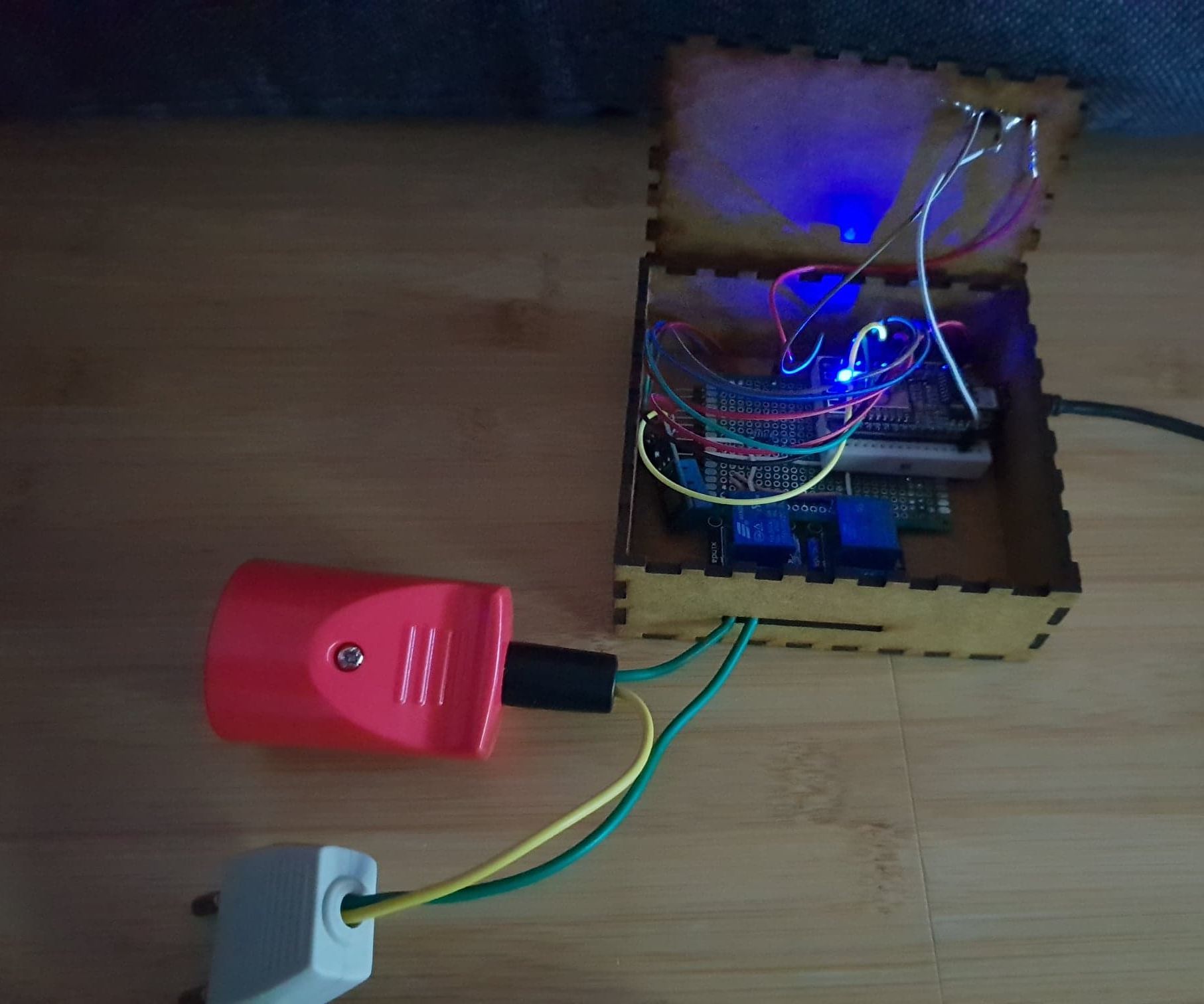

Introduction: UCL-IIOT - Data Loggings on Raspberry Pi
This instructable was created by Obayda Haj Hamoud and Sidse Henriksen for a school project.
The main idea is collecting data from alight sensor, logging the data to a database wirelessly on a raspberry pi and monitor that data through a dashboard created using Node red .
Step 1: Building the Circuit

Step 2: Arduino Code
The following code is used to call the mosquitto broker installed on raspberry pi and get the published data.
'The final arduino file is inserted in the end of this instrutable'
