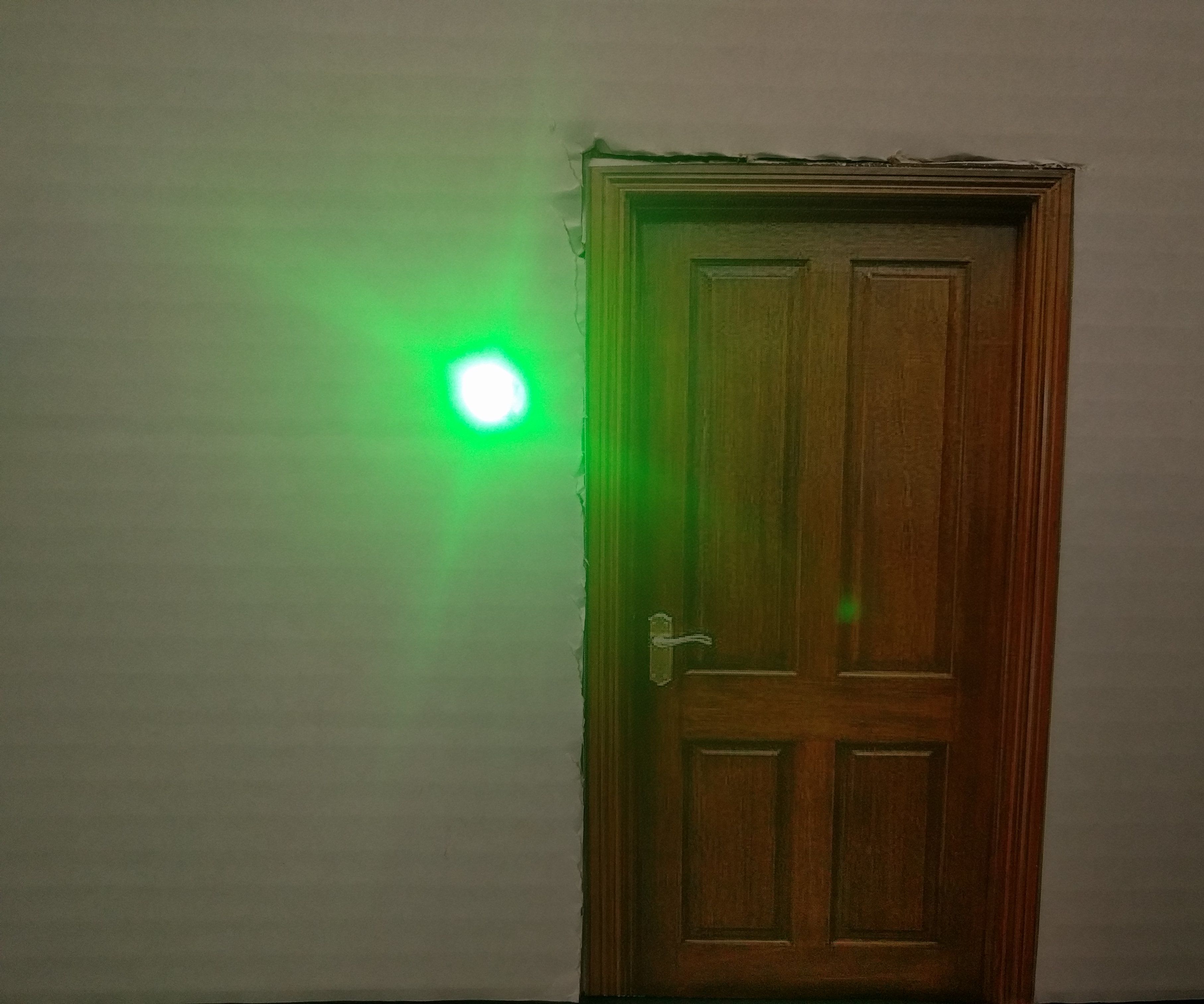

Introduction: UCL-IIoT-Security System
This is an educational project building on our previous project found at https://www.instructables.com/id/EAL-Embedded-Security-System/ aiming to get familiar with webservers, databases and communication between those and an arduino board.
Step 1: Overview
In this instructable, using our previous project (linked to at the top), we will aim to show how to set up a webserver and a database to handle logins for the security system. This time we are going to switch our Arduino Mega out with an Arduino UNO board from Wemos. This board has a built in ESP8266 WiFi module, which we are going to use to communicate with the webserver. We have also updated the Android application to send a username as well as a password, opening for the possibility of distinguishing between who logs into the system. Had the system been implemented on multiple entities you could also administrate what users would have security access to what entities.
The webserver is being implemented using Node-Red (a block programming tool for building webservers, using Javascrip and Node-JS). Using the Arduino boards WiFi connection the webserver gets logins, looks them up in the database and communicates back to the Arduino bard whether or not the login should be accepted. Furthermore you can administrate the users in the database through a graphical user interface on the webserver, as well as view which users logged in at what times.
The database is being built using MySQL and consists of two tables: one table containing a list of usernames and their corresponding passwords and another containing a log of successful logins with usernames and timestamps.

Step 11: Evaluation
Discussion
Comparing to the previous project, the hardware implementation is still pretty barebones. However a lot of backend features have been implemented. It is now possible to have different users with different passwords and manage said users from a userfriendly graphical user interface on a webserver.
