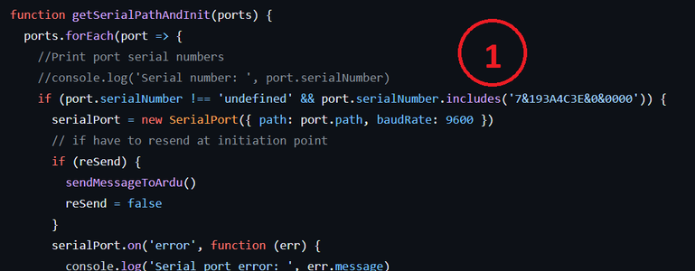

As you can see we have two main parts in the code, we have the UDP configuration that sets the ports that we will be using and the actions that will be executing in the message reception. On the other hand, we have the serial port initialization and functions that will be finding the serial port (getSerialPathAndInit) and writing to that port (sendMessageToArdu). So basically, at the moment the program starts the function initSerial() is executed, and the binding module lists the ports and executes the getSerialPathAndInit function. This function loops through the ports and finds our Leonardo board by serial number. You will have to modify this string in order to put the serial number of your board. You can know this serial number, by printing all the serial numbers of the located devices. (1)

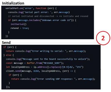

Once the board is found, we initialize the serialPort object and assign it to the shared variable so it can be used by other functions. We set the behavior of the program in case of an error by doing this (2).
When an incoming message is detected by the server containing a certain string, an attempt to send a message to Leonardo is executed, the message will contain our password.
In this way, the password will not be stored on the Leonardo board but on your laptop or computer.
As you can see, also here, we handle possible errors. We do that basically just to make our code more resilient to certain situations. For example, if the USB got disconnected after being initialized. Or the serial port was never initialized, due to starting the program without the USB connected.
This situation will be handled by the program by re-initializing and resending the message.

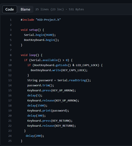

Now that we know how to handle the server part we will be doing modifications to our Arduino Loeanardo sketch accordingly, in order to handle the incoming message from the computer. As you might remember we were sending the password at the button press. In this case, we will be listening to the serial in the Arduino loop by serial read string function and finally doing exactly the same as the button press was doing.
