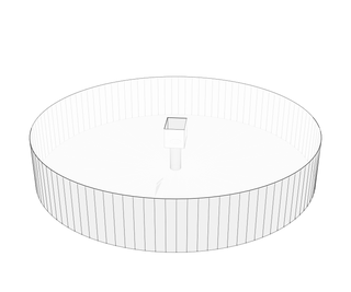

Print at 100% fill: axle support, body3, (8) led holders, rear wheel, topb, (2) wheels

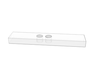

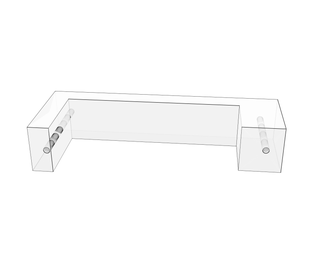

The rear wheels, axle support and body look like this.
Step 3:

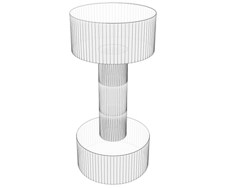

Place the rear wheel assembly in the channel in the axle support, then melt the axle support to the body. I melt the PLA pieces together using a soldering iron.

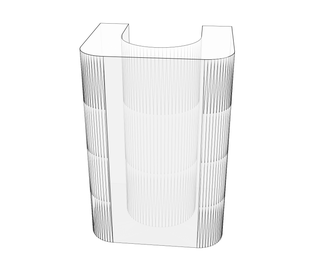

Place the motor inside the body--note the little "nub" on one side of the motor that fits into the body.

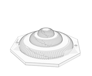

Print the saucer base and saucer top.

Attach the top to the body by melting together with a soldering iron.
