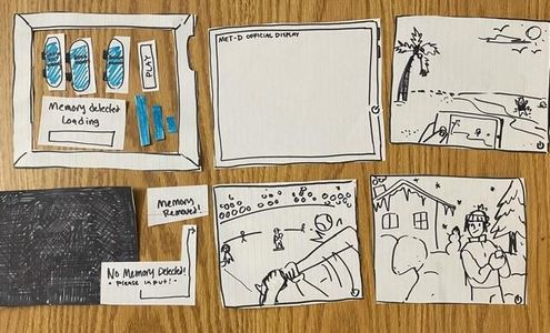

Step 1: Make Components
The key to a P2 (Paper Prototype) is to have every button and screen cut out so you can place them down where needed. In this P2 there are 3 main displays, each of them build off of the background (the top middle) cutout.
This screen is blank so messages or buttons can be place on it to make different scenes. The "input memory" scene (display 1) is built on top of this, and so is the loading bar (display 2).
When a memory is "inputted" in this P2, the loading message is placed on screen. Once loaded, the start button is placed. Touching this makes one of the larger cutout memories cover the whole screen (display 3). Even here, there is a power button that can bring a black cutout over the top of everything else.
The key is to anticipate every interaction and know what cutout should be placed down when something else is interacted with.
