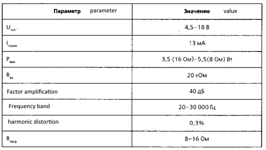

Miniature bridge power amplifier with low frequency electronic volume control. In this amplifier output stage provides protection against short circuit, thermal protection (overtemperature shutdown as a result of heavy loads), as well as protection against voltage surges and static electrical discharges. It can be applied to electronic volume controls, as described above, and conventional potentiometers. Pin assignment is shown in Table. 3.7. The main technical characteristics are shown in Table. 3.8. Connection diagram is shown in Fig. 3.22. The image of the PCB shown in Fig. 3.23. Arrangement of components on the board is shown in Fig. 3.24.

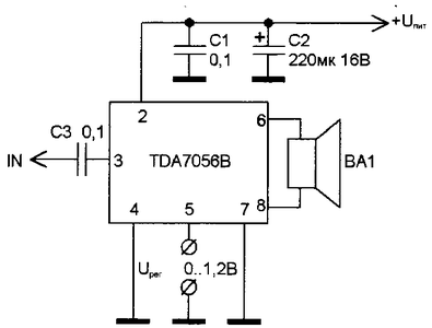

Step 1: Step 1
Fig. 3.22. circuit-breaker

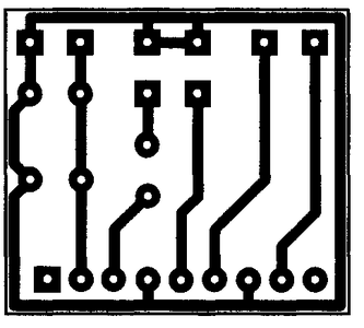

Step 2: Step 2
Fig. 3.23. Image of the printed circuit board

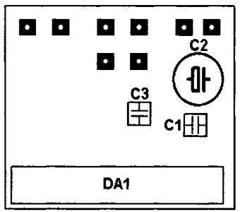

Step 3: Step 3
Fig. 3.24. Arrangement of components on the board
