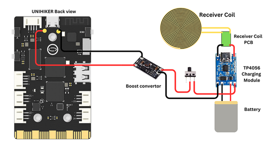

  3. Wireless charging coil - 1Pc
  4. TP4056 module - 1Pc
  5. Slide Button- 1Pc

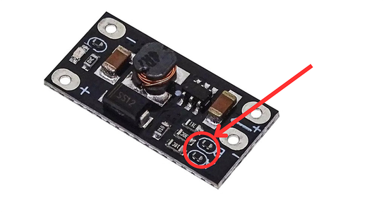

  6. Boost converter - 1Pc

Step 4: Final Schematic Explanation
DO NOT MISS THIS STEP ELSE IT MIGHT BURN UP YOUR UNIHIKER
If you are using the same Boost convertor Module, make sure to remove resistors A and B to get 5V on output.
When the receiver coil is energized by the transmitter coil, it begins charging the battery via the TP4056 charging module. When the button is turned on, it turns on the boost converter and powers up UNIHIKER. Please do not connect cable to UNIHIKER When it is powered by battery else you may end up burning your UNIHIKER board.
