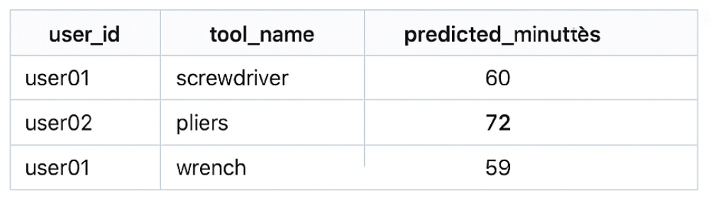

✅ 4. Predict return time Use ML to predict when a borrowed tool is likely to be returned based on past behavior

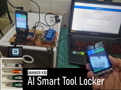

Step 3: System Overview
Each user ID card contains 2 QR codes:
Top-left QR = “Borrow”
Top-right QR = “Return”
📦 Borrowing Process:
🟢 Press a button to begin
📱 Scan the “Borrow” QR code on the card
🔓 System automatically unlocks the cabinet
🛠️ User takes a tool and scans the QR code on the tool (e.g., screwdriver, pliers, hex key)
🔒 The system automatically locks the cabinet
☁️ Data is uploaded to the web server, recording who borrowed what and when
📥 Returning Process:
🟢 Press the button again to begin
📱 Scan the “Return” QR code
🔓 Cabinet unlocks
🛠️ User places the tool back and scans its QR code
🔒 The cabinet is locked again
☁️ Return record is logged to the web server

Step 6: EXAMPLE AI Table

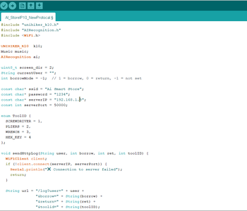

Step 7: Code
Step 8: Circuit
