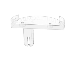

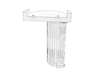

Step 2: Design
I quickly took measurements from the printer itself and started modeling my new parts in 3d. I decided to make two separate parts for the spool holder and guide so that I could make use of all four mounting screws. The original holder seemed a little too flimsy to adapt for a 1kg roll.
I strongly recommend sketching your concept before modeling in 3d. I was a little hasty with this project because I wanted to start printing right away. I was lucky that my first printed parts were successful. I find when you work too quickly, you end up with printed parts that don't work, because you miss some minor detail.
Step 3: Finished Product
Last thing to do is take off the old holder and screw on the new one. This one works perfectly!
