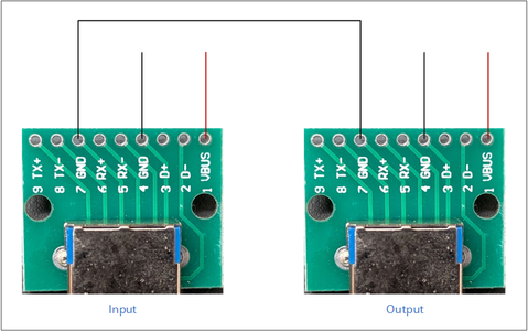

Step 3: Connect Voltage and Ground Wires
Notice how I labeled the USB ports as input and output in the figure; this becomes important if you're using a switch with a LED. I'll explain this later.
The USB 3.0 ports have two ground connectors, but we only need one on each side for the power switch
Cut three black wires and two red wires to the appropriate length required to connect between the two USB ports; I used 3.5 inches for mine.
Solder one of the black wires between the Input USB Port's GND connector and the same GND connector on the Output USB Port.
Solder one of the black wires to the open GND connector on the Input USB port. Do not connect the other end of this wire to anything at this time.
Solder one of the red wires to the VBUS connector on the Input USB port. Do not connect the other end of this wire to anything at this time.
Solder one of the black wires to the open GND connector on the Output USB port. Do not connect the other end of this wire to anything at this time.
Solder one of the red wires to the VBUS connector on the Output USB port. Do not connect the other end of this wire to anything at this time.
When you're done, you'll have one wire connecting the two USB ports and two sets of red and black wires, one set connected to each USB Port connected to nothing. We'll connect the open red and black wires to the switch later.

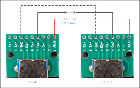

Step 5: DPDT Switch Connection
If you're using a DPST switch for this project, use the instructions here. If using a SPST switch, jump to the next step.
As I said at the beginning of this Instructable, I chose a DPST switch with an LED in it so I could easily tell when the switch was powered on. You can also use a DPST switch without an LED in it, but its really not necessary without the LED.
Mount the switch in the enclosure, making sure to orient the switch in a way that makes the most sense for you. I positioned mine so down turns the switch off and up turns it on.
Start by figuring out which set of switch posts power the LED. If you look at the close-up of the switch I used, you'll see two wires snaking out and wrapping around the switch posts at the top of the switch. Those are the connections that power the LED.
To make this work correctly, you must connect the power (red) and ground (black) wires from the Input USB port to the opposite wires from the witch posts with the LED connected to them. You must also figure out the polarity of the LED connections, one post connects to ground and the other connects to the input voltage (the red wire). If you have documentation for your switches (I didn't), then you can just figure this out from the docs. If not, you can figure this out pretty easily with a little trial and error.
To validate LED connection polarity, switch the switch to the On position then take a 5V power source with two wires, one for voltage and the other ground, and connect them to the lower switch posts (not the ones with the LED wires connected to it). if the LED turns on, you've got it, you've nailed down the LED connection polarity. If the LED does not illuminate, then switch the polarity of the connections, basically switch the wires to the opposite sides of the switch.
Next, with the LED illuminated, turn off the switch. If the LED turns off, then you're all set. If it stays on, that means that you're working with the output side of the switch, not the input.
When you have this all sorted out, solder the red and black wires from the Input USB port to the correct posts on the non-LED side of the switch. Then solder the red and black wires from the Output USB port to the matching connections on the other side (the output side) of the switch. You must have Red/Red on one side of the switch's connections and black/black on the other.
You can see the completed connections on the image for this step.

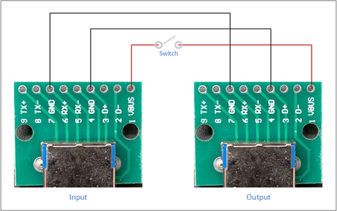

Step 6: SPST Switch Connection
If you decided to use a SPST switch in your project, complete the following instructions.
Solder the unconnected black wire from the Input USB port to the black wire on the Output USB port. This connects both ground connections to each other on both sides.
Next, solder the voltage (red) wire from the Input USB port to one of the switch connections (it doesn't matter which one) and connect the voltage (red) wire from the Output USB port to the other switch connection.
That's it!

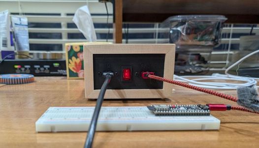

Step 7: Testing
Connect a USB-A to USB-A cable between your computer system and the Input port on the switch. Next, connect a USB cable between the Output port on the switch and an external device.
When you turn the switch on, the device should power up. With the device powered on via the switch, you can deploy code to the device and interact with it from the computer system like you would with a normal USB cable.
