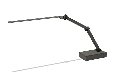

After I started at my new college, I was at home doing some homework and my shadow was blocking the light so I could not see the work clearly. This was very annoying for me as it made it much harder to do my work and there wasn't anything I could do about it.
I looked online to find a desk lamp but a lot of them had a massive lamp shade which would get in the way, and I didn't really like the look of them. So, I decided to make my own lamp which would be thin whilst still having enough structural integrity to hold up the lights and didn't look bad.
Another goal was to make it powered by USB-C. This provides an element of future proofing, and it would be easier to use it in different places, because I wouldn't need to carry around a large power brick with it. I would only need a USB-C cable and a somewhere to plug it in, which means it could even be powered by a power bank if there were no other options.

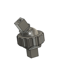

I wanted it to be able to be adjusted so I can have it in any position that I want, ball joints would be the best for this because they have a really good range of motion.
I fired up Fusion 360 and started designing.

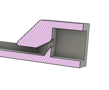

Step 3: Put the LED Strip in Place
First you need to thread the wires through the hole at the end of the bar. Next, you need to stick the LED strip to the bar. If your LED strip has adhesive backing, peel off the protective film and press the strip in place. My strip did not have self-adhesive backing, in this case use some double-sided tape cut to the width and length of the strip and stick it to the bar.

First you need to assemble the ball joints by placing the ball side of the joint into the cup, then screw on the collar to hold the joint in place. Take care not to overtighten and damage the thread. Test the movement and sand/smooth any parts to ensure the ball joints operate easily. Repeat this until all the ball joints are assembled.
Next slide the first ball joint along the wire, with the ball pointing towards the light and push it into place in the square socket. Next slide wires into the first long arm section, press the square connector of the ball joint into the square socket of the arm. Repeat this process for the next arm and two ball joints, and then insert the last ball joint into the square socket on the base. Don't force the parts in place because they might get damaged, if they are too tight, lightly sand the parts down until they are a snug fit. On the other hand, if it is too loose you can use some superglue to keep it in place.

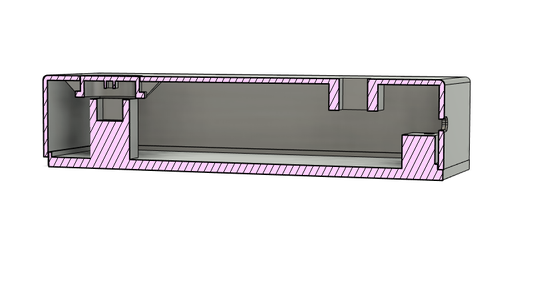

Step 5: Cut the Switch Wire to Length
Cut a piece of wire so it is long enough to stretch from the port block to the switch block, allowing a little slack.
Step 6: Thread the Wires Through and Solder to the Switch
It is very important that you thread the wires from the arm through the top part of the base and then through the switch block. With the wire threaded through the top part of the base solder the red wires to the switch pins 1&2 indicated in the picture, either side of the switch will work. When the solder has set you can push the switch into place in the square hole of the switch block, making sure that the pins sit either side of the centre support. Once the switch in in place that you can solder the red wire to the VBUS on the USB-C breakout board.
Step 7: Putting the Breakout Board in Place
Solder the black wire to the GND on the board and screw it into place on the supporting block as shown in the picture with the two M3 bolts, careful not to overtighten and damage the thread.
Step 8: Add Some Weight and Put the Button in Place
Find something to use to weigh down the base, this will help the light stay steady when adjusting the arm, but it not is totally necessary, it will stand up without additional weight. Next put the button in place between the two guides as shown in the picture
Step 9: Put the Top On
Place the top part of the base on the bottom of the base, making sure to line up the square socket in the button with the square top of the switch, to make sure the on/off button will work. Press the top into place and ensure a good fit, once you have connected power via a USB-c cable and tested the light you can glue the two parts together.
