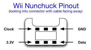

You will either need to use a Nunchuk connector breakout board or cut the connector and connect the bare wires. In that case, check which signal matches which wire colour. The colours tend to be illogical. Use either the attached connector pinout (pulled from here) or the printed labels on the Nunchuk PCB.

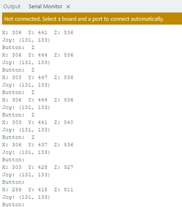

Upload the example sketch shown below to the Pro Mini. The example makes use of the WiiChuck library v0.3.2. Note that later versions break the example. Additionally, the library barely fits in the 2048 bytes of RAM available on the Pro Mini (ATmega328P) and is likely to go unstable if you add many local variables.
Ensure that the Pro Mini prints text and numbers which change when you move the remote and manipulate the controls. If that's the case, the system works as expected.
Pro Mini to Nunchuk schematic:
VCC-VCC
GND-GND
A4-SDA
A5-SCL
Nunchuk Example sketch pulled from this Adafruit tutorial:

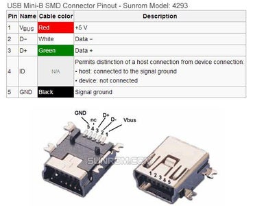

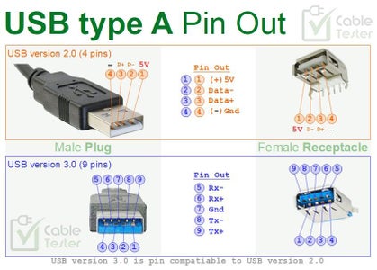

Connect this cable directly to your FTDI programmer after removing the original connector. The procedure will probably require some SMD soldering, but it should be possible. A hot air gun may be advantageous. Try to find open, connected pads for the GND and VCC pins to avoid putting all the SMD soldered wires next to each other.
The attached diagrams may be helpful for determining which signal is which:
  1. USB mini pinout.
  2. USB type A pinout.
Check all connections and ensure there are no short-circuits using a multimeter.

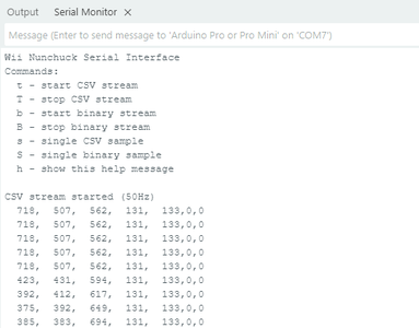

Attached is an Arduino sketch implementing a full serial interface written mostly by ChatGPT based on the above example. The serial interface allows a CSV or binary stream mode, which sends 11 bytes per packet and single-sample binary and CSV packets.
Screenshots showing the printout from the CSV stream mode (at 50 Hz) and the graphical demo are included. These are taken while shaking the Nunchuk in all directions (Accelerometer XYZ readings at the top of the plot), and moving the joystick in a circle (middle two lines).
Note the F macros in the sketch to keep the static literal text in flash memory and save RAM. The interface sketch uses 1793 of the available 2048 bytes of RAM. When modifying the program, care should be taken to avoid flooding the serial port immediately after program start, as this may interfere with the upload procedure.
