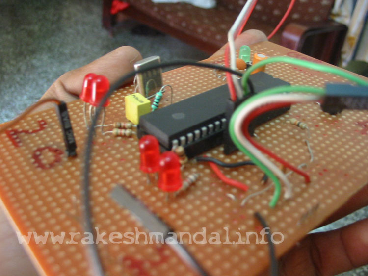

This a small project on controlling D.C motor with USB pic18f4550 interface board with L293D motor Driver.
A small application [C#] is controlling my pic18f4550 USB interface board with my computer, enabling me to control my board with keyboard. The output of the microcontroller is given to the input of a L293D motor driver , hence enabling me to control my DC motor in ( forward / reverse ) that is Clockwise and Counter Clockwise | anti-clock (cw/ccw) direction.

USB + C# [HID] > pic18f4550 > L293D > DC motor
Schematic for USB Motor Driver
You can find the Schematic for this USB DC motor controller in the pictures here. Its a Single DC motor interface to pic18f4550 however two two interface is possible.

You have to make my USB Demo interface board first to make this project done, once you are done connect the l293d with power and connect it with pic18f4550 as i have mentioned in the video "Introduction to L293D"
