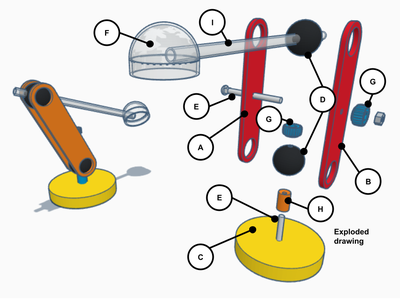

Step 1: Tinkercad Work and STL Files
You can extract the STLs for 3D printing and SVGs for laser cutting (I use Inkscape to convert the SVG to a DXF if, like me, your laser needs that format) from the Tinkercad drawing above. Alternatively I have made the fabrication files below. The sides were made from 4mm ply but I guess any sheet material you can llaser would work.
The side panels are different, one has a square hole so that the coach bolt locks in place.
Key to exploded drawing:
A: Square hole panel (Laser cut)
B: Round hole panel (Laser cut)
C: Base (22mm Pine)
D: Deodorant balls (2x)
E: M6 Coach Bolts (2x)
F: Deodorant lid
G: M6 nut spinners (2x 3D printed))
H: Swivel Socket (3D printed)
