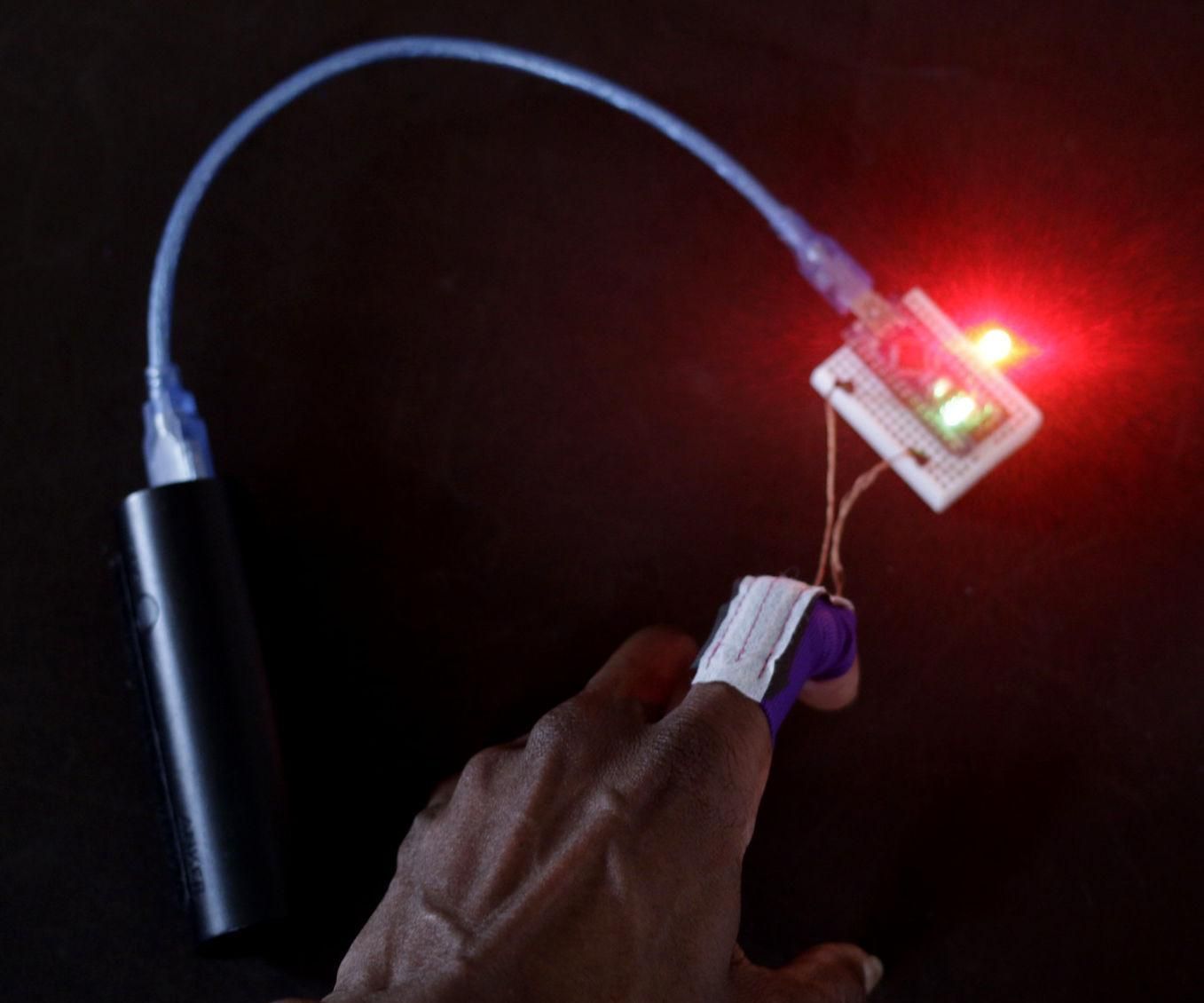

Step 5: Testing
I plugged my Arduino Uno and ran the blink example file to test the new cable by placing the LED positive on 13 and its negative into ground.
It's nice to have a short cable when working with Arduino, versus the really long ones, which can make the workflow awkward.
