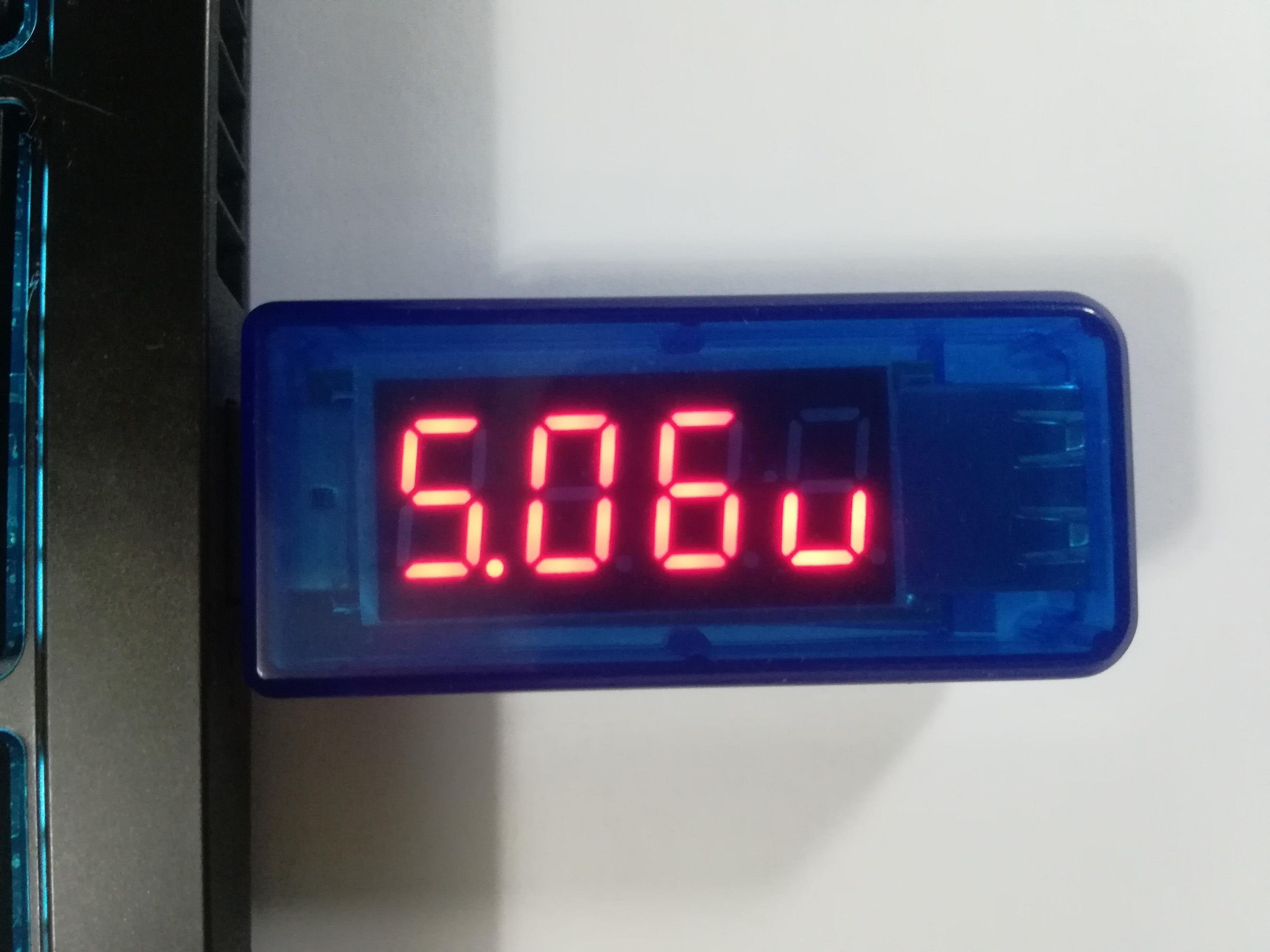

Step 4: Assemble the Arduino in a USB Hub
I chose to hide it inside a USB hub because it is just a daily used gadget on my desk and a non-suspicious one
1 - After choosing which USB hub model to work with you can start opening it and assemble your Arduino in it.
The chosen USB hub should have enough space in it to fit the Arduino board, a reed switch and 4 wires for connections
2 - Choose a USB port to solder your Arduino USB interface internally to it, you will disconnect this port and it will be unusable from outside the hub
3 - Test to see if the components will fit inside and their most suitable orientations
4 - I removed the chosen USB port LED so it will appear as a broken USB port to any user
5 - Cut the D+ and D- Lines connecting the USB hub IC and the USB port
6 - Scratch these two lines (from the IC side not from the USB port side) and solder them to two enameled thin copper wires (enameled copper wires are coated with thin transparent layer of isolating material so they are isolated from each other), You will need to add some hot glue over these wires because they can break easily from their solder pads.
7 - Make sure you know which wire is D+ and which is D- (The pin closer to the 5V pin is D- and the the pin closer to the USB Ground pin is the D+)
8 - Desolder the USB Mini connector from the Arduino Nano (You might need a hot air gun for that or just a soldering iron, some solder wire and patience)
9 - Add a ground wire to the Arduino GND pin and solder it to any ground point on the USB hub, then solder the USB port enameled wires to the USB pads on the Arduino
10 - Isolate the Arduino Nano using electrical tape but keep the 5V pin out of the tape because we will solder the reed switch to it
11 - Isolate the reed switch terminals and be cautious when bending its terminals because the switch glass can break easily
12 - Connect one terminal to the USB port 5V pad and the other terminal to the Arduino Nano 5V pin
More about reed switches here
13 - Completely isolate the Arduino Nano using many layers of electrical tape
14 - Test if every thing is fitting inside the USB hub case, If they fit then close it and see the next step for how to use it.
The Arduino didn't fit from the first time so I had to desolder the reset button to decrease its thickness.
