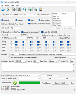

Step 2: Flash the Firmware to the Micro Chip
Flash the pre-built firmware to the chip by using the WCH Link Utility software. You may also download the source code and build your version. (Link to my Google Drive)

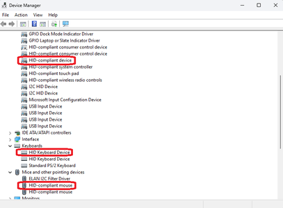

Step 3: Plug the USB Jiggler Device to Your Computer
Once you have plug the device to your computer, 3 HID devices will show up in the device manager. One keyboard, one mouse and one HID device.
