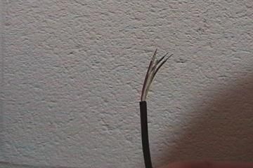

Step 2: Strip and Cut Usb Cable
well, it's what it sounds like. use wire a wire stripper or scissors to cut and strip the usb cable (keep the end that plugs into your computer, obviously.) then strip the black and red wires inside of it. (if yours is strange and doesn't have black and red, you'll have to lick the wires to find out. go on, it's only 5 volts :))

I forgot to take a picture, so I just included the usb one.
