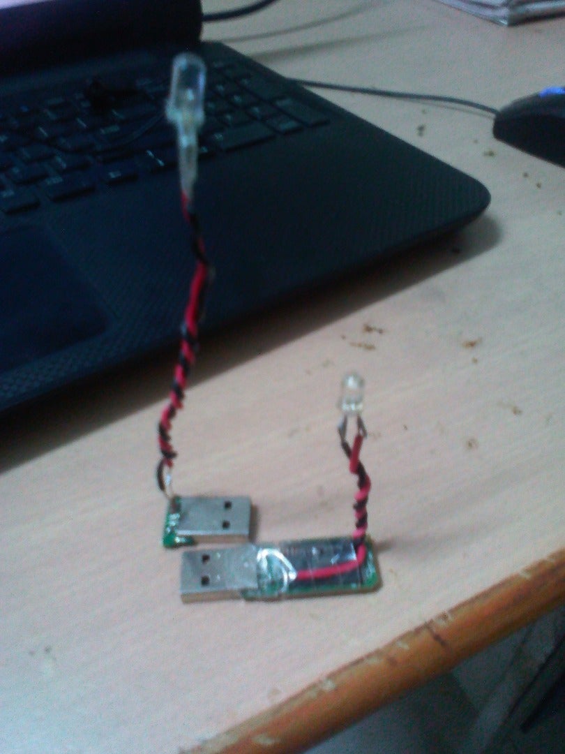

Step 2: Step 1:
the usb pin has four pins and the lower one is positive and the top one is the grnd
solder a 100ohm resistor to the grnd pin and a wire to the positive pin.
then fix a led to the wires. seeing the positive and the negative correctly.
after completion this would show a look like those on the pics.

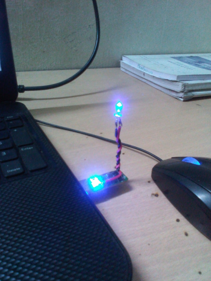

Step 3: Step 3: Conclusion
alright after all this pin it to the usb port in ur laptops and enjoy the lights..........................
Step 4: USES
1. better view of keyboard at dark
