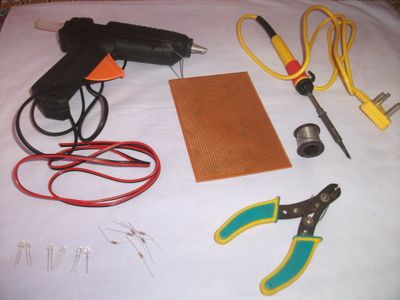

TOOLS&EQUIPMENT
-Soldering Iron
-Soldering Wire
-Hot Glue Gun
-Wire Cutter
-scissor

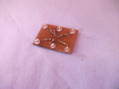

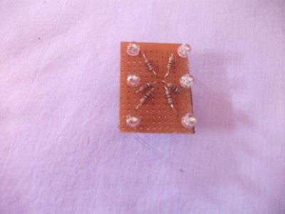

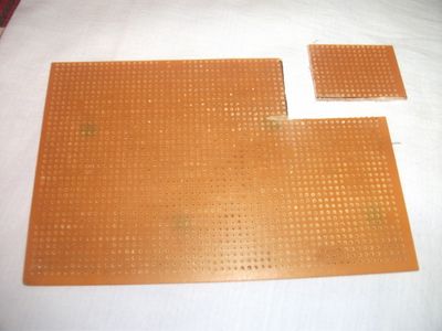

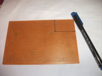

* Cut the common PCB board for required size.

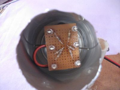

* Assemble the LED s and Resistors in PCB and Make soldering

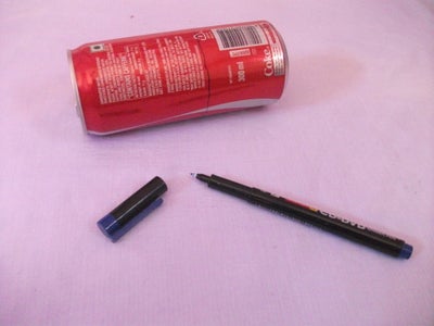

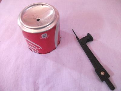

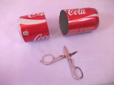

* Mark and cut the cool drink tin into half using scissors.
* make the hole under the cool drink tin using compass.

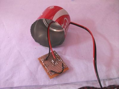

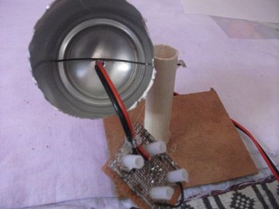

* Pass the one end of the wire through the hole and solder with the circuit's +ve and - ve ends.

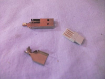

* Take the USB male port and solder the other end of the wire with proper pins.

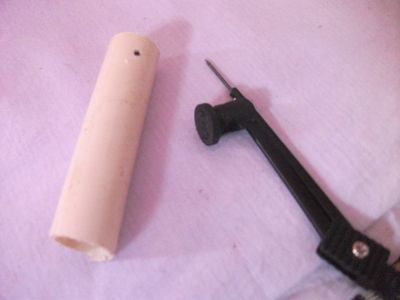

Step 3: MAKE THE STAND

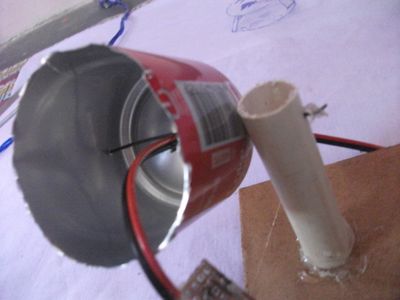

Take the plastic pipe and make small hole on it.
For the same take the cool drink tin and make the hole on bottom of it.
Take the wooden piece and place the plastic pipe on wooden board using Glue gun.
Take the iron wire and pass through the plastic pipe and cool drink tin.
Bend the iron wire on both ends and glue it in correct position.

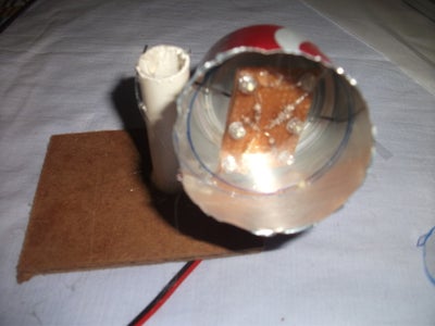

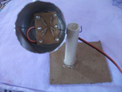

Place the PCB into inside the cool drink tin.

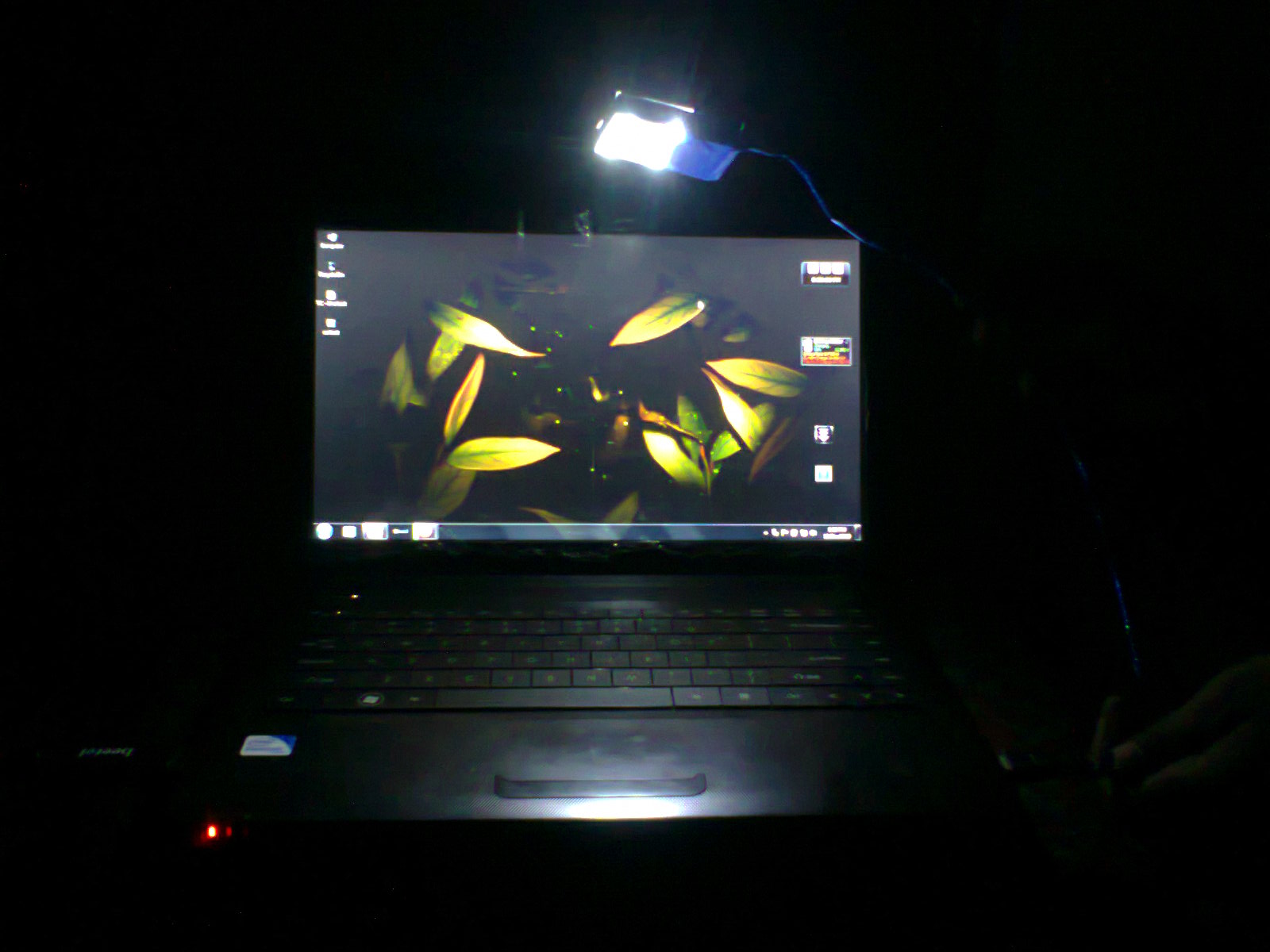

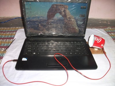

Connect the USB male port in USB female port and it starts working.
