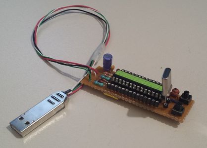

Step 2: My Own AVR USB Device
My kit is based on the USnooBie development Kit (USnooBie):
“The USnooBie is a microcontroller kit that does not require any sort of AVR programmer or USB-to-serial converters to load and run compiled code. It's hardware design allows the user to develop low cost USB devices with Atmel's AVR ATmega microcontrollers. It can also be used to develop projects which are not USB devices. It is even compatible with Arduino.”

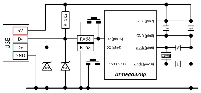

I have adapted the schematics and remove the voltage regulator and kept only the zener diodes to limit the D+ and D- voltage (see the schematics image). All these specifications are detailed on the V-USB Obdev site (V-USB Obdev)
The needed components are the following:
- 1x Atmega328p
- 1x USB connector
- 1x 12MHz crystal
- 2x 3.6V zener diode
- 2x 22pF ceramic capacitor
- 1x 100nF ceramic capacitor
- 1x 4.7μF electrolytic capacitor
- 1x 1.5kΩ resistor
- 2x 68Ω resistor
- 2x mini push button switch

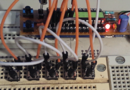

Step 4: The Result
You can see the result in this short video.
The device is recognized as a MIDI controller.
In my case, I assigned it to a Piano keyboard and I send “Note On” and “Note Off” MIDI message by pressing and releasing some switches.
