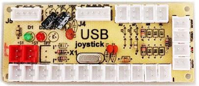

We will use a cheap Bosega CY-822A "zero latency" USB arcade controller, to convert the foot pedal position (potentiometer position) into a low latency digital input. There are other similar arcade PCBs available, that may be used as well as long as analog mode can be enabled. These controllers are usually available for a few $ online.

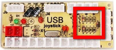

The controller can detect four analog joystick direction: X, Y, Z and Z Rotation. It does so by measuring the difference in resistance between the upper resistor and lower resistor in the right hand bank of resistors (R1 to R8).
However, since these boards will mostly be used for digital joysticks connected to the sockets AU,AD,AR,AL socket above, the resistor bank is fixed with a single pair of equal resistor and a PCB lane on the backside connecting all resistor pairs to the first. Connecting the AU switch will lower R1 to near 0 ohm. AD will connect R2 and so forth.
This means that the controller is actually an analog controller with fixed resistors, so all we need to do is replace the resistors with the potentiometer reading from our pedal.

To make the controller analog, we need to disconnect the fixed resistors for the axes we need.
The axes are X, Y, Z, Z Rotate for R1/R2, R3/R4, R5/R6, R7/R8.
It is easiest to connect to the right most resistor pair, however I found it difficult to map Z Rotation to MIDI later, so I recommend using the Z-axis and the following instructions is for the Z-axis, which require a little more work.

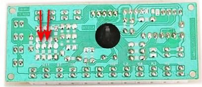

Seperate R5/R6 and R7/R8
All resistor pairs are are connected in the center with a PCB lane on the backside to share the R1/R2 resistors. This lane needs to be cut between R3/R4 and R5/R6 as well as between R5/R6 and R7/R8. Two cuts. See image.
Use a scalpel and a steady hand to cut through the line and verify with a multimeter that the risistor pairs have now been separated.

  • Solder the VDD wire to any of the top holes in the resitator bank. All top holes are connected to VDD, so any VDD point on the board will do.
  • Solder the RA wire to any of the two wholes between R5/R6.
  • Solder the RB wire to any of the bottom holes in the resitator bank. All bottom holes are interconnected to RB, so any hole will do
Reconnect R7/R8 to R1/R2
The R7/R8 (Z rotation) was diconnected, so we have to reconnect it to R1/R2 again. Otherwise the joystick controller will constantly produce random Z rotation events.
  • On the backside of the board, solder R7/R8 to R1/R2 with a short piece of wire.
