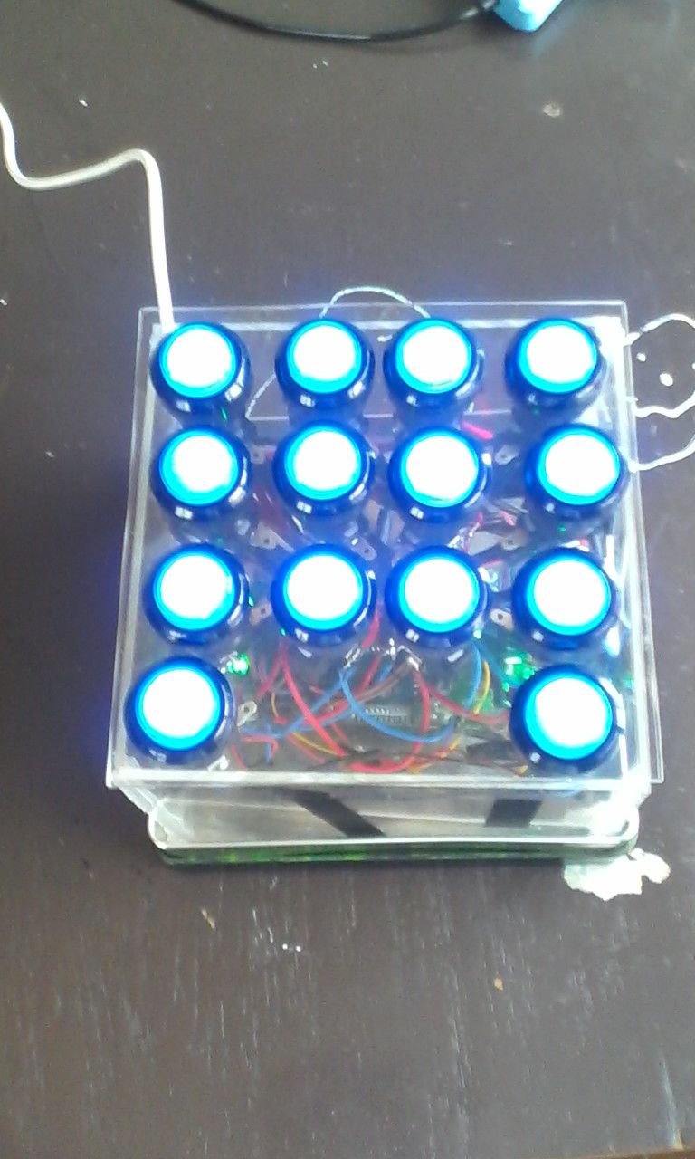

You can spend a lot of money on an expensive USB Midi device, or make your own. You can buy HID USB boards and build your own totally from scratch. To make the process even easier, salvage an old USB gamepad and all you need is just a few parts. This project can easily be done for under $10, if you get cheap buttons and a second-hand controller.
What you need:
1 USB Gamepad (I used an old Gravis Gamepad Pro.)
1 small project box
10 push-button n.o. switches (Normally Open: Contact closes when button pressed.)
10 LEDs & 220-Ohm resistors (optional)
These parts should run you about $10, less if you scavenge LED and switches from old electronics. Substitute a small kid's lunch box for the project box and be old school!

Alternatively, you can figure out which of the button contacts is the hot and which is ground. You can connect multiple grounds together. Each button's hot will still need its own wire.

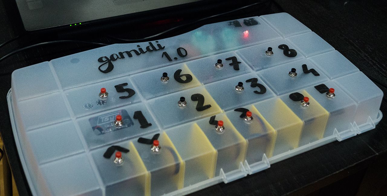

Step 10: Make a Template
Make a template for your device. Space your buttons apart for easy access but not too close as to accidentally trigger. I include my draft which is for a 15cm x 10cm x 6cm project box. I chose to use the base of the box because I didn't want to see the screws.
Step 11: Measure and Drill
Use a ruler and a square to find the center points for each hole and drill. Use a small bit to drill a pilot hole and increase the size slowly. You don't want to crack the plastic forcing a large bit. You can go ahead and mount in the switches after you have drilled all the holes.
Step 12: Solder LED to Switch (optional)
Solder the positive end that has the resistor attached to one end of the switch. It can be either pole of the switch.
Step 13: Secure the Control Board to the Project Box
I glued a piece of cardboard into the base of the project box and screwed the control board into it.
Step 14: Solder the Pad to the Switch
Solder the positive ends of the gamepad controls to the other pole of the switch. Connect up the ground ends to the common ground point.
Step 15: Drill Hole for Strain Relief
Use the strain relief the manufacturer provided. I drilled a hole in the back and fit it in so the cord can't be ripped from the assembly.

i still confuse how to connect the led to triggering? but i make it paraller and finally i done!

Hi guys! just have a question on the led part. Does it light up on press?.. cause if it is... this is freaking awesome. Im planning to make a midi fighter style out of this project.
0
shaider328
shaider328
Reply 4 years ago
And is 220ohms resistor enough to make ultrabright leds lit up? Or what happens to the leds if i press buttons simultaneously?
