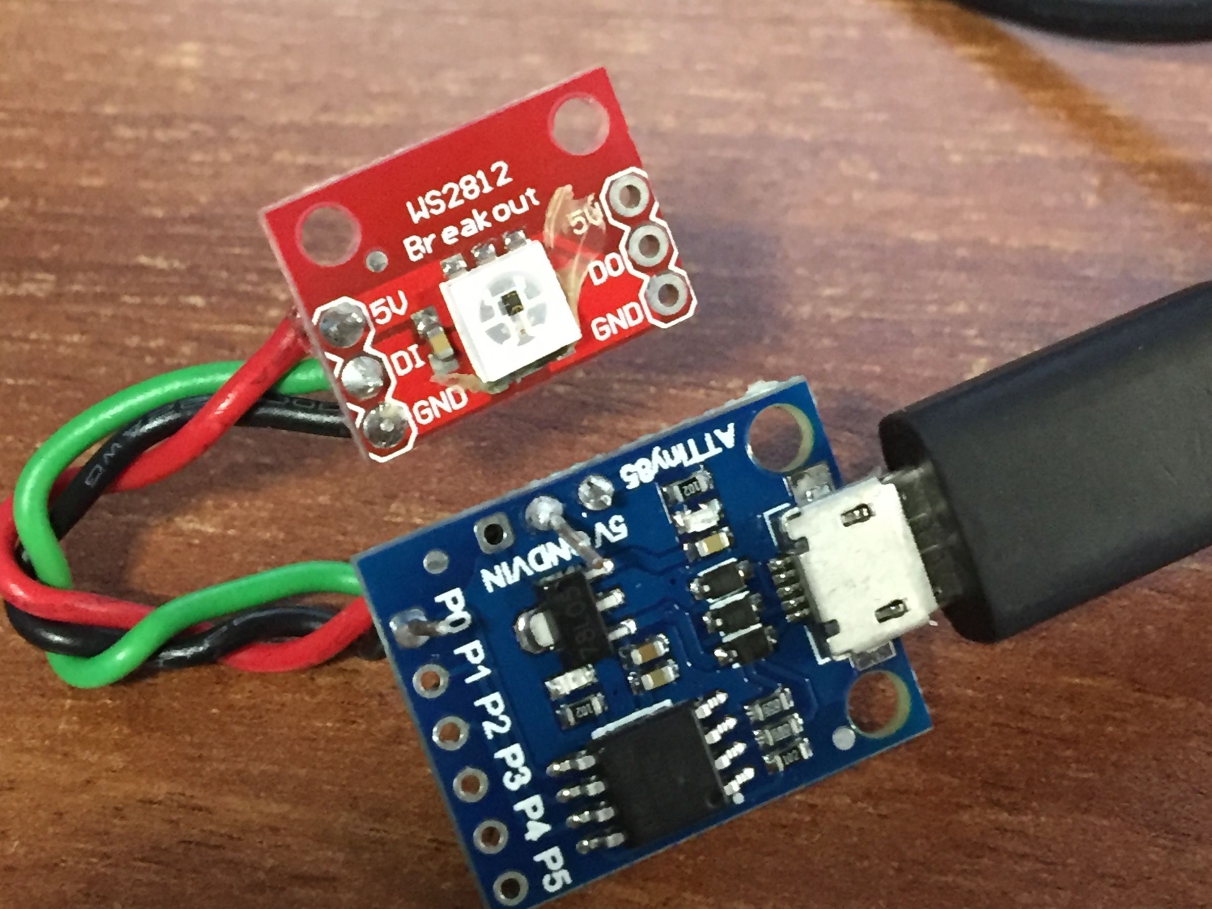

Step 1: Wiring

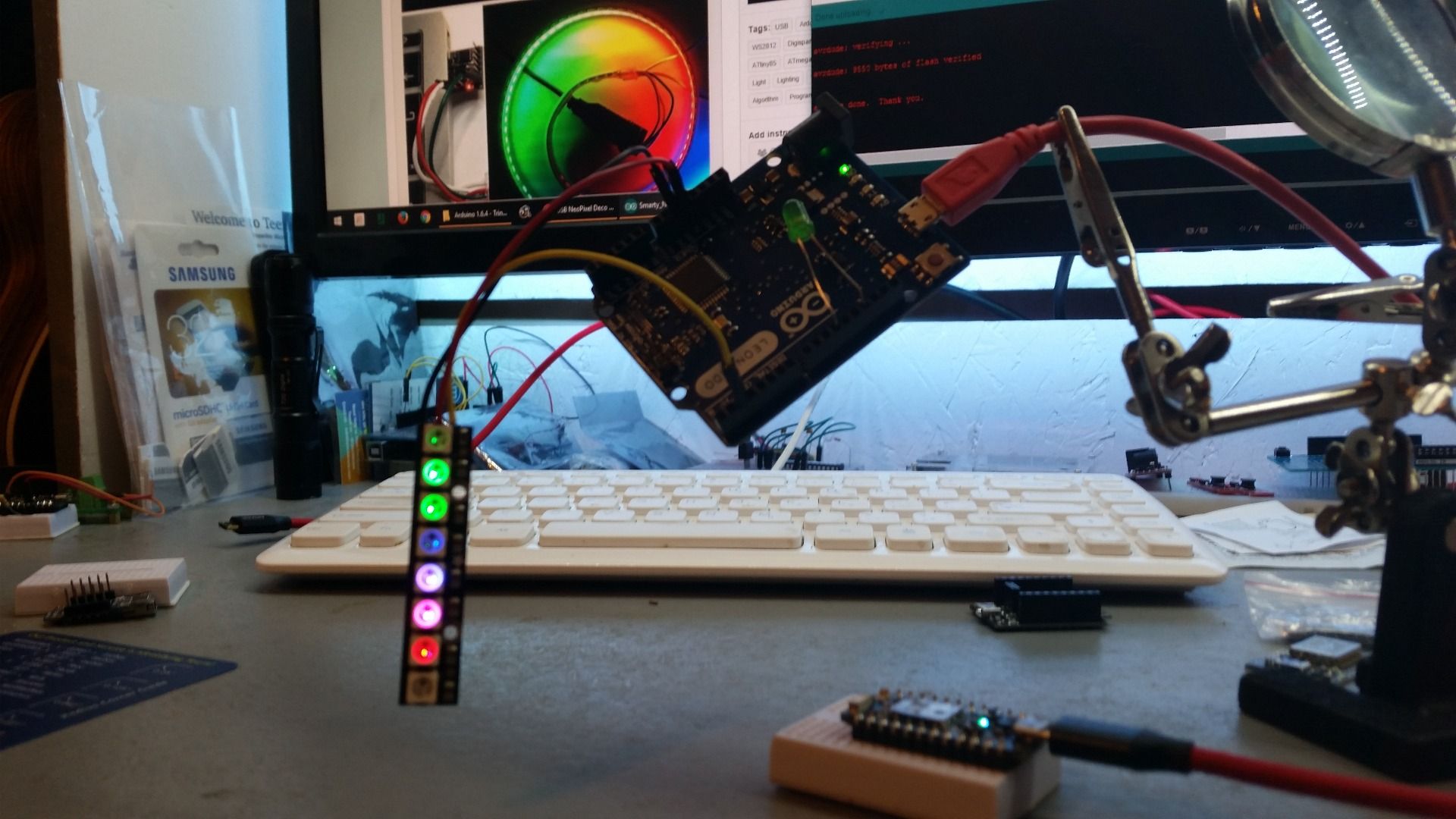

Most WS2812 strips comes with three-wire connectors. I removed the plastic casing of the connector and connect wires to pins directly (they fit well). White is GND, red is +5V and green is data input.
Most LED strips have additional power lines on both ends. This wires are usually naked, so make sure to isolate it (otherwise you may accidentally short-circuit it).
Please note that LEDs require a lot of power. If you have a strip of 30 LEDs, you can run it on full brightness directly from any PC or USB power supply (it will consume less that 500mA). About 100 LEDs will work as well on low brightness, but if you want more, you'd better off with a separate power. For long strips it is recommended to apply power from both ends, for extra-long strips, connect additional power lines each 100-200 LEDs.
WS2812 receives color data serially, so you can control virtually any number of LEDs with just one data pin. You can use any digital output pin (do not forget to put correct number in the code).
Once we connected a strip, let's get to the coding part.

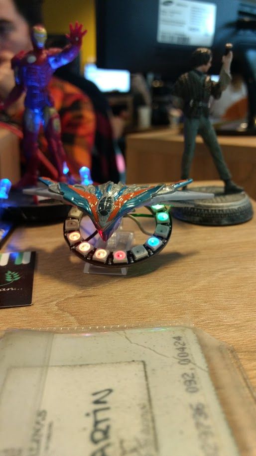

For example, I made a metal ring for one of my projects and glued one of the strips to it. Now it is a nice decoration light you can put on a wall or a ceiling. Putting a strip near a window pane results in a nice reflection (as you could see on a photo).

Finally, you can plug Digispark into any powerbank and enjoy your gadget in portable mode. Glue the strip to a handbag, a garment, or a bicycle and use it as a unique personal accessory .)

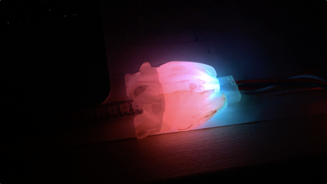

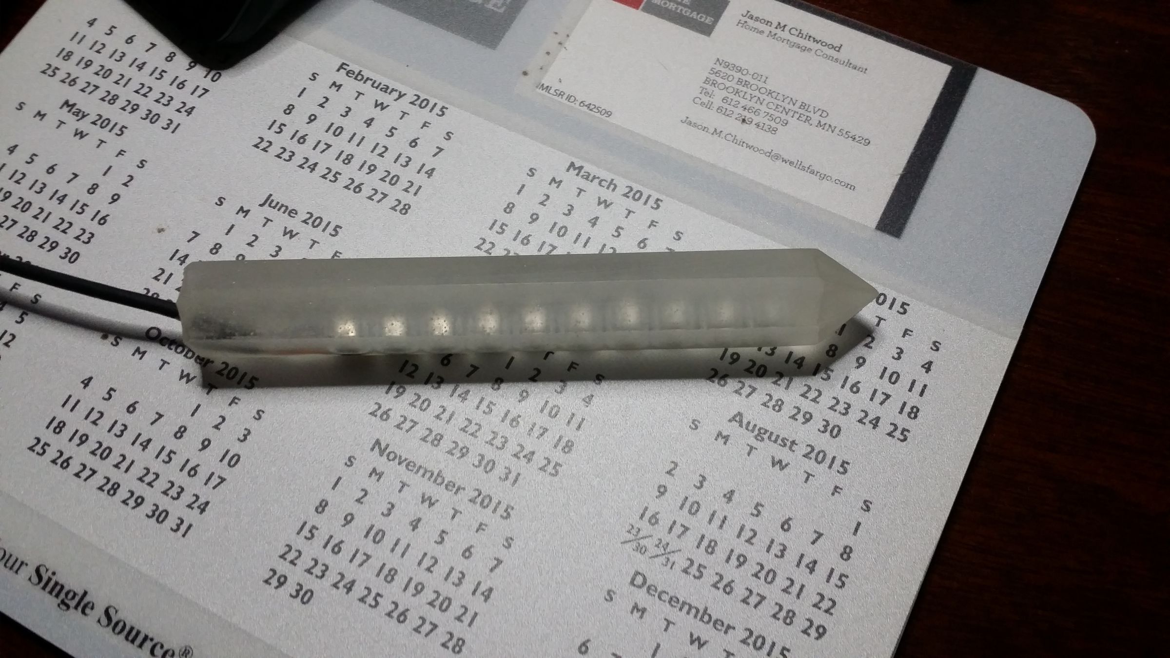

I made a fountain-light for my sister by encapsulating ten discrete Neopixels in resin, and sanding it to look like a quartz-crystal. then with the digistump, and a cellphone charger, (along with this awesome code) her magic-fountain is REALLY magical now!!

Thanks Dan! I'm going to experiment with NeoPixels in plastic (or even stone) as well. Here is my brief sketch (just put a tiny stone turtle over a WS2812 strip). Could you share what sort of resin you were using?

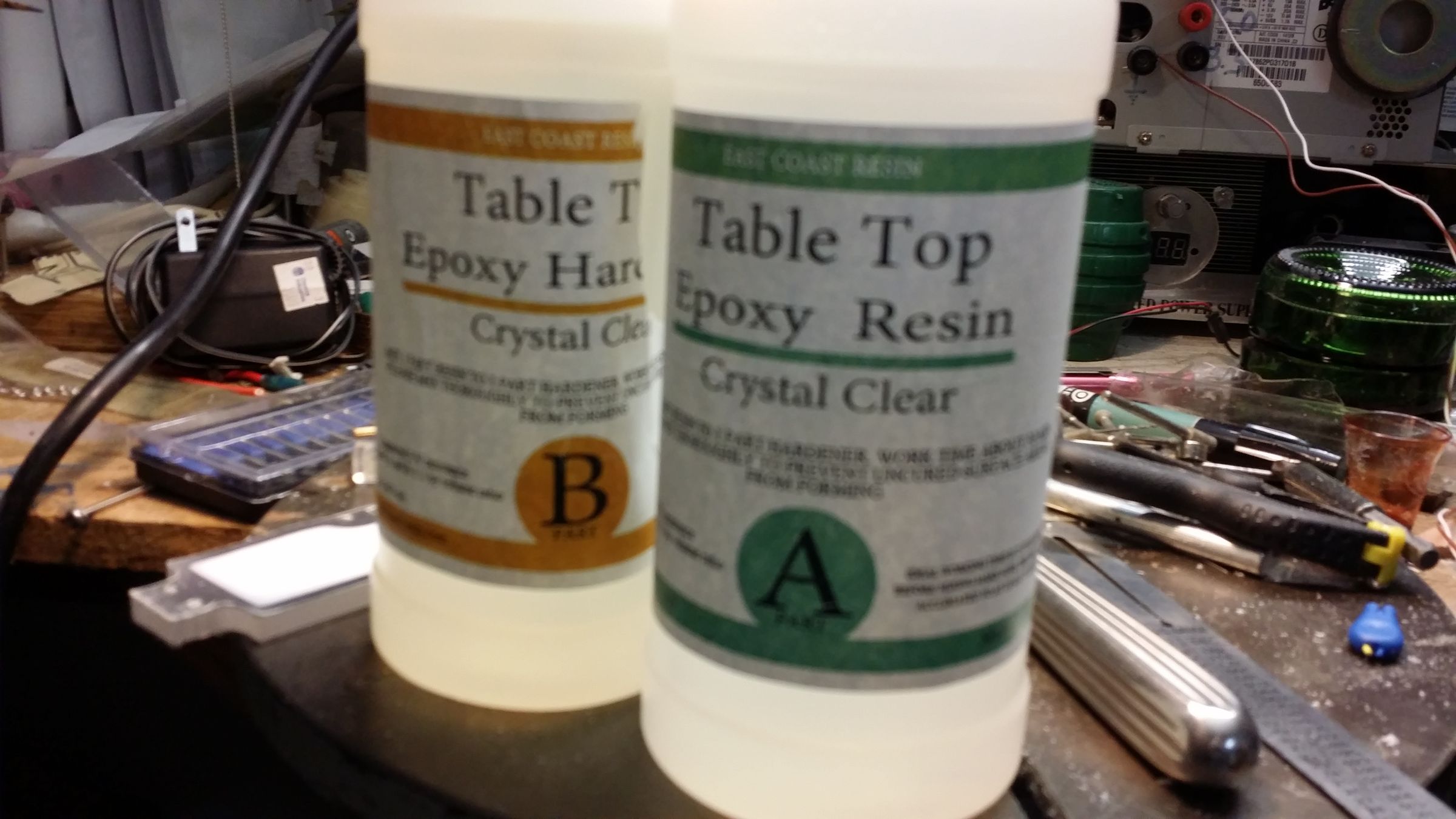

It's a two-part table-top epoxy. I chose that because there isn't a lot of heat generated during curing like there is with some other casting resins.
