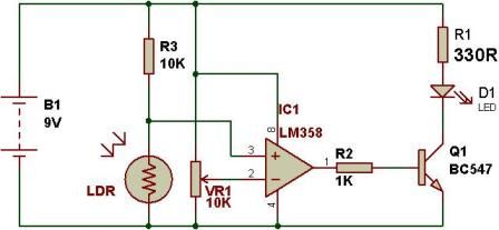

Before actually soldering the circuit together, I put the components together on a breadboard. After making sure that the circuit works, I start soldering them together.
Note: In this circuit only one Op Amp in the chip is used.

Start up the soldering iron and prepare the components, making sure they all all present. I start by desoldering the SMD LEDs from its flex circuit (no picture) and then I continue by soldering the USB connector to the board, then the socket, then the LED's, transistor, resistors, LDR(put the heatshrink tubing over one of it's leads), variable resistor. After that, I wire all of the components together.
After all is done, I checked for shorts and test it by plugging it to a usb power source and it comes alive.
