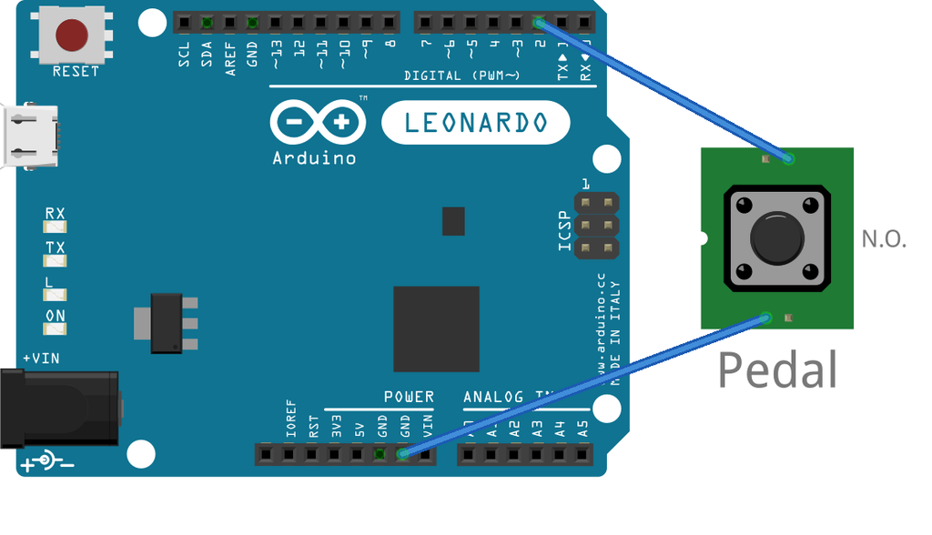

At least one pedal (switch) should be connected to an Arduino Leonardo board.
Connect the switch between GND and digital pin 2.
If you have a second pedal, connect it between GND and digital pin 3.
Note: I use a N.O. (normally open) switches.

Step 6: Arduino Sketch
The Arduino sketch below sends a [Page Down] keyboard keystroke by pressing the pedal with your foot on digital pin 2.
An optional second pedal can be connected to GND and digital pin 3 to send a [Page Up] key.
Connect a (micro) USB cable between the Arduino Leonardo board and your computer. Open the Arduino IDE and copy-paste the following code:
