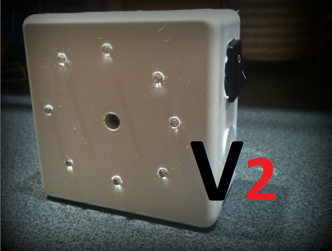

Step 2: Preparing Parts and Project Box
I started by modifying battery holder and project box to fit each other.
Then i placed parts in project box and arranged them in order which they fit best.
Step 3: Soldering
Soldering is pretty straight foward.
Just solder positive to positive and negative to negative ,just remember to add switch between one of those wires so you can turn power bank on and off.
Step 4: All Done
After soldering all parts together you can put in batteries and close project box and your done!
This is how my project turned out , I'm pretty happy with result and it definitely dose what it's made for.
