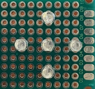

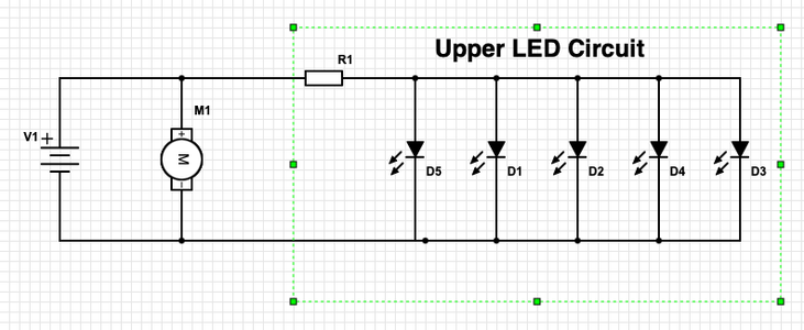

The circuit for this project is straightforward with the fan and LEDs all in parallel. The trickiest part is soldering up the LEDs on the perf/prototype board to fit in the top section of the bug catcher. If this project gets enough interest I might design a simple open source PCB to make life easier, so let me know if that's something people would be interested in.
If you're using a perf/prototype board like I am then I'd recommend the following LED arrangement (ignore the orientation of GND here, this is just to show the location). Ultimately the number and placement of the LEDs is not overly critical, they just need to be able to fit in the mount opening.
