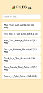

- Custom File Server: Upload your own trail essentials—knot guides, plant IDs, audiobooks, you name it—and access them anytime.

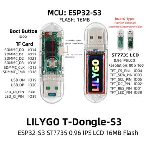

- Lilygo TDongle S3

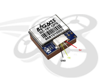

- BZ-181 FPV Gps Module

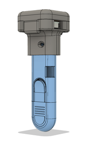

- 3D printed gps holders (optional)

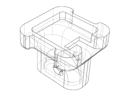

Step 1: Print GPS Holder
Bringing Your Backcountry Beacon to Life – One Layer at a Time
It’s time to fire up the 3D printer and create the custom parts that will house your GPS module and keep everything secure. I have embedded the part files below to make it easy to review the parts before printing.
Download the 3D Models:
- Head over to the parts3D/ folder in our GitHub repository (insert actual link) and download the STL files for the GPS holder and any other components you plan to use.
Printing the Parts:
We printed these parts using a resin printer with ABS-like material to ensure durability. We used the following settings:
- Supports: Auto supports at 80% support density
- Layer Thickness: 100µm (0.1mm)
Due to the smaller features of the design, we can’t guarantee how it will print on an extrusion (FDM) printer, but if you’re familiar with tuning your machine for detailed prints, feel free to give it a try!
Don’t Have a 3D Printer?
No worries! These parts can be purchased online from various 3D printing services. Just provide them with the STEP files, and they’ll do the rest.

Step 2: Wiring the GPS Module
Now that you’ve got your custom parts ready, it’s time to wire up the GPS module.
Both the T-Dongle S3 and the drone GPS module use Qwiic connectors, making the connection straightforward—almost. The catch is that while they share the same connector, the pin configurations are different. You'll need to swap the pins on the GPS side of the connector—a delicate operation, but once complete, you’ll have a working connection.
Qwiic Connector Pin Configuration:
- T-Dongle S3 (Qwiic): GND, 3.3V, TX (T-Dongle), RX (T-Dongle)
- GPS Module: 5V, RX (GPS), TX (GPS), GND
Adjust the Pin Order:
To match the correct pinout, carefully use a small flathead screwdriver or a pin extractor tool to release each pin from the GPS connector housing. Reinsert them in the correct order according to the pin configurations above.
If you are unfamiliar with this process, there is an example of how to remove and re-insert these pins here.
For clarity, I have shown my cables pin positions clearly, so it is easy to replicate.
Connect the GPS Module to the T-Dongle S3:
Once the pins are correctly ordered, plug the Qwiic connector into your GPS module and connect the other end to the T-Dongle S3. Make sure the connection is secure and that the wires aren’t strained or loose.
With the wiring complete, your GPS module is now ready to start communicating with the T-Dongle S3. Next, we’ll move on to installing the GPS holder and getting everything assembled!
Step 3: Installing the GPS Holder – Snap, Slide, and Secure
Assembling Your GPS Module – It’s That Simple
Putting together your GPS module with the T-Dongle S3 is a breeze. Just follow these simple steps:
- Connect the Cable: Start by connecting the Qwiic cable between the T-Dongle S3 and the GPS module. The pin order is already configured, so no need for extra adjustments.
- Place the Bottom GPS Holder: Slide the bottom GPS holder onto the T-Dongle S3. It should fit snugly, but if it feels too tight or loose, you can lightly sand or shape the 3D-printed part for a perfect fit.
- Position the GPS Module: Place the GPS module onto the bottom GPS holder. Make sure it sits securely in place.
- Snap on the Top Holder: Carefully snap the top GPS holder over the GPS module. It should click into place, keeping everything securely together.
- Optional – Secure with Tie Wire: If you’re planning on some rugged adventures, you can add an extra layer of security by tying a piece of wire around the assembly. This will keep everything locked in place, even if things get bumpy.
And that’s it! Your GPS module is now securely attached to the T-Dongle S3 and ready to go. Remember, if the 3D-printed parts don’t fit perfectly right out of the printer, a little sanding or shaping can make all the difference.

- Trail Resources: Whatever you might need on the trail—knot-tying guides, plant identification PDFs, or even a tv shows for those stuck in your tent.

- Plug the LilyGo S3 USB dongle into your computer using a USB cable. Make sure PlatformIO recognizes the device by checking the bottom bar in Visual Studio Code for the connected COM port.
