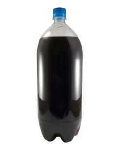

The first step in this project is to cut your 1.5L or 2L plastic bottle into two parts. Plastic bottles come in many different shapes, so try to use one which you will be able to cut so that the two pieces naturally fit together.
I originally used a mineral water bottle which had hippy curves, cutting out the hourglass shape allowed the top to sit snugly onto the bottom and create a closed space. I also tried this with a Jaffa bottle which had a long conical top. Using the most common shape of bottle, if you cut it about 1cm below the bottom of the cone, you should be able to squeeze the top onto the bottom.
There are a lot of bottles laying around, so try to find one already used instead of buying a new one ;)
