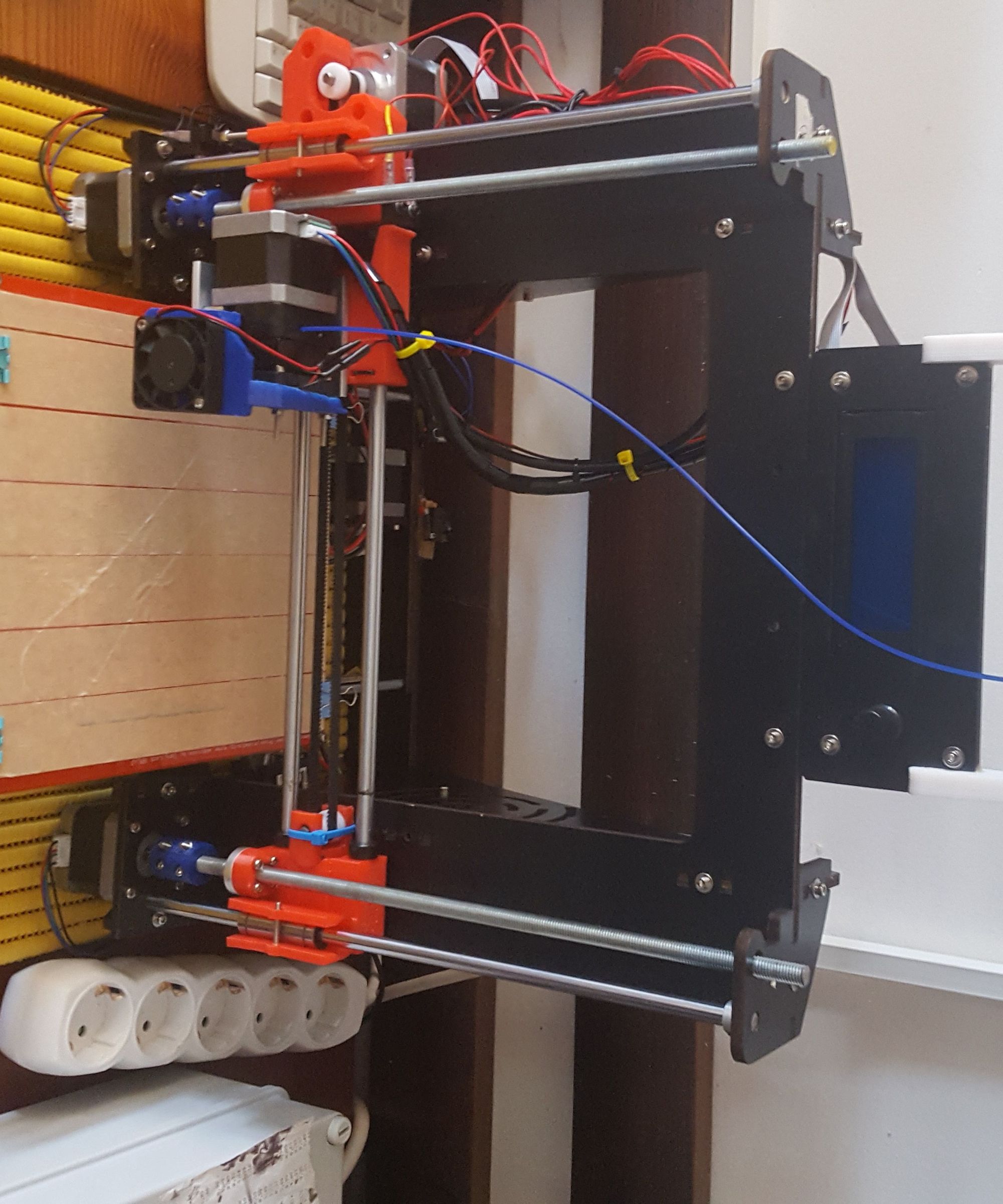

Step 4: Print All the Parts
This are the parts i desined in sketchup.
I made a difuzor for the top, but you can use the light without it.
The difuzor is made out of one of the layers from a broken LCD screen that i got laying around, you can use paper aswell.
I printet the parts with PLA
205 °C nozzle
60 °C bed
120 mm/s
I forgot the hole for the USB cable so i just drilled one later.
