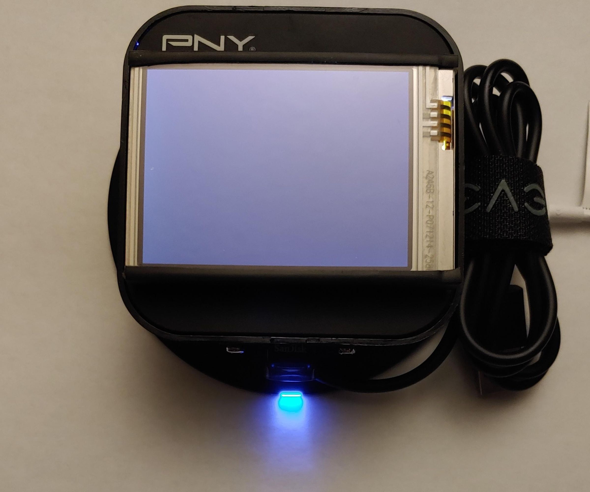

I found this mini network router GL-AR150 with a USB2.0 Samba server that supports many file systems including NTFS.
Pro: Adds smooth FMV and large file system sanity. Portable. Works on LAN.
Con: Router takes about a minute to boot.
The GL-AR150 runs openwrt
and this means the device could be over-clocked or customized in many ways.
The WAN interface is still available and works on the LAN.
