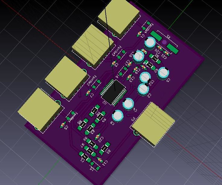

  • First of all print the mirror gerber file on the photo paper only using laser printer. I attached the gerber file in the downloads section. You can open the gerber file with the help of any gerber viewer.
  • Then cut the required portion only from the full paper and mark the cutting portion on the copper clad using any sharp tip marker. I used OHP Marker. You can use any gel pen that will also work.

  • Now place the components at their respective places. It's little bit tough to solder TQFP package but try soldering it with small soldering iron. Also use flux on the pins.
  • You can refer the 3D viwer and Schematics pdf for the components placing.
