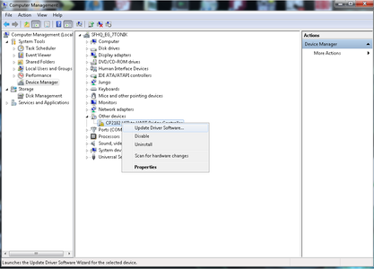

Step 6: Drivers for CP2102:
Now to setup the interface of computer COM port with CP2102 hardware, we need a software driver which can recognise the device and then help the IDE to upload the code. You can download the drivers from here and then locate the position of installed drivers after going into device manager for proper working.

After updating the driver settings you can see the cp2102 name in the ports section inside device manager of your computer. Then make all the connection with Arduino according to the above given schematics. And choose the right COM port inside Arduino IDE, select the board and Programmer as AVR ISP, Hit enter and upload the code. Enjoy the new Journey of Embedded system with me, Follow for more content.
