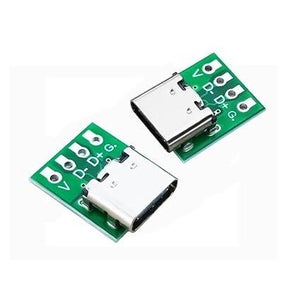

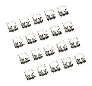

We connect the V+, D-, D+ and Ground pin a shown in the diagram building the basic adaptor
